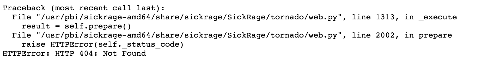

I got it all in, only sickrage is giving me issues right now, trying to see where i went wrong with that one
it doesn't automatically redirect to its webroot, add /sickrage to the URL
Thank you, that was it,

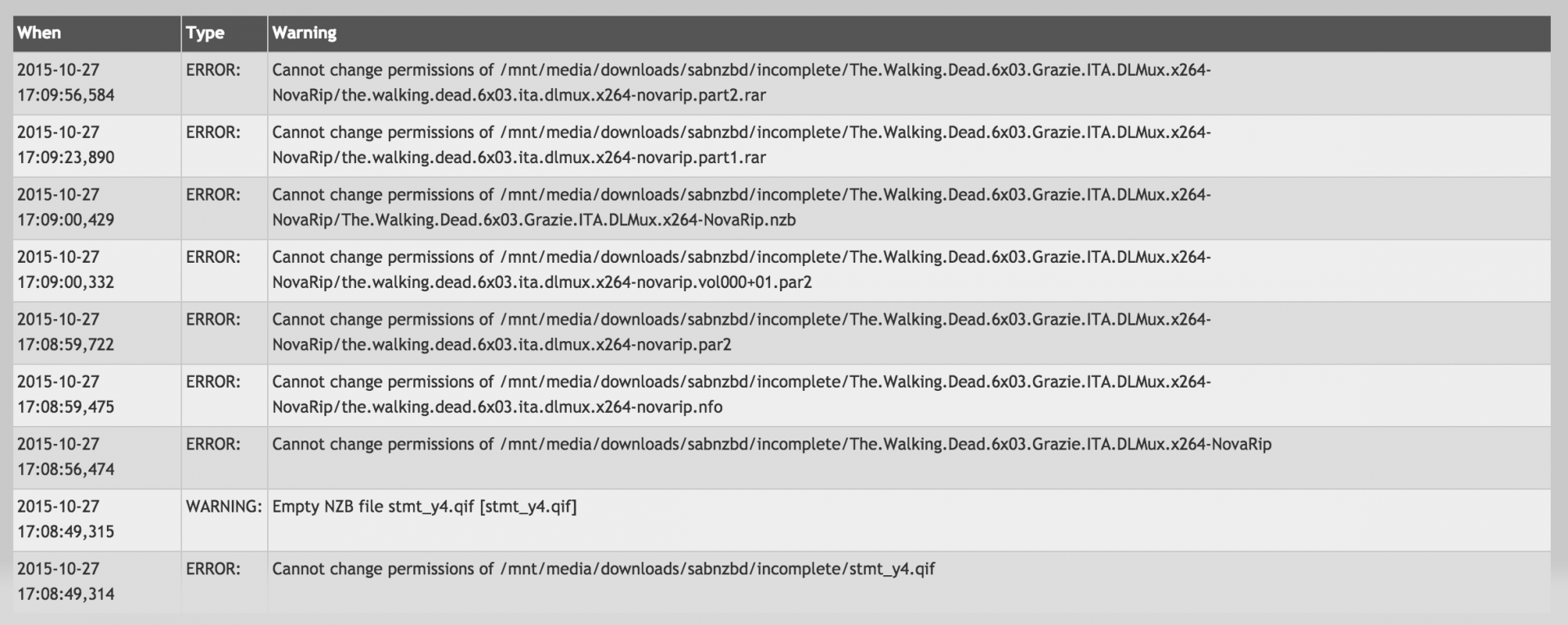

Anyway,..I seen to have some type of "permission" issue. I got all 3 plugins up and running. they "seen" to be working. however I added a Show on Sickrage and a movie on couchpotato and they were found, but they were never sent to sabnzbd.
So to start i manually uploaded a nzb file to sabnzb and this is what I am getting...

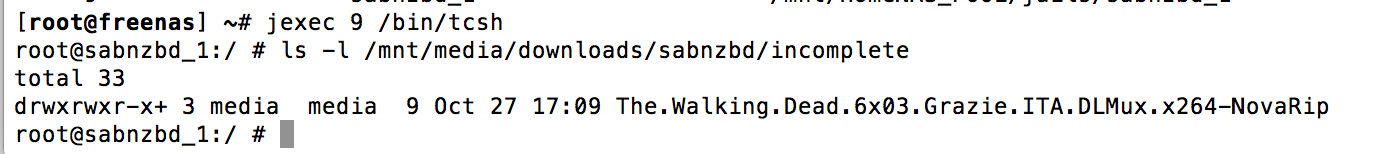

the chown step should have changed the ownership of that directory. can you check the output of 'ls -l /mnt/media/downloads/sabnzbd/incomplete'

windows ACLs?
no window machine in my network... only pFsense, Freenas and 2 macs
do i need to recreate the datasets?
not sure, but I would check your dataset settings. the + is the problem.

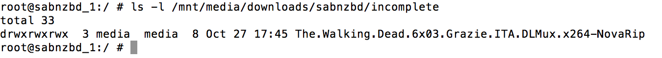

Not sure how that happened,,, but anyway, recreated the dataset and recreated the directories....
+ is not gone....
