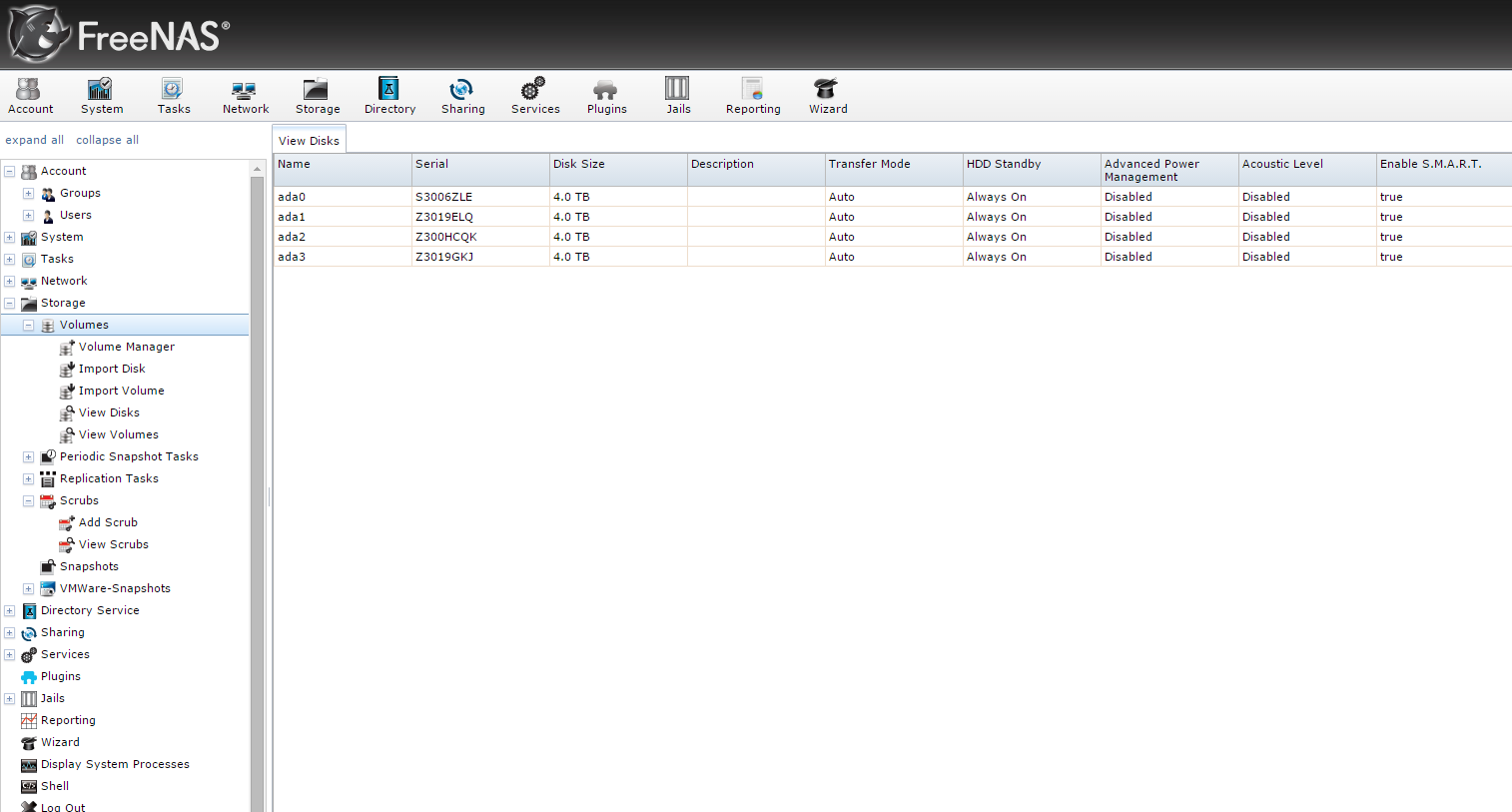

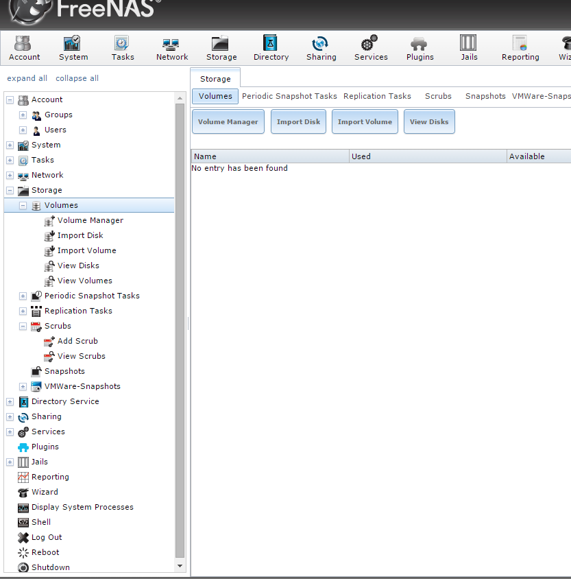

rbrookstx
Jan 23, 2015
8
I just got home, and I don't have auto import volume. as an option. If I choose import volume, nothing appears in the drop down. the disks are clearly seen however.

Update: I have recovered my original USB key, it no longer sees my volume either. it sees the disks, it sees the mount (though it shows an error about being unreadable). I'm at a loss as to what I can do without an entirely new wipe and rebuild of my 10Tb volume (something I don't want to do if I don't have to. At this point. I just want to recover the data that appears to be there. I've acquired 3 6Tb drives and I'm going to build a temporary array so I can begin the restore process and have a place to store my recovered data temporarily while I troubleshoot this.
