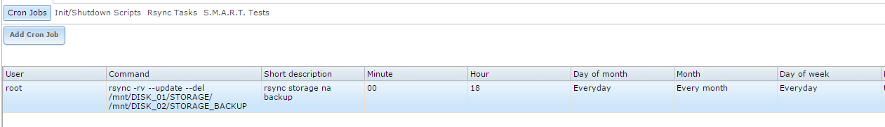

Hi, I´m new in FreeNAS.
My FreeNas knowledge is basic.
I´m runing with FreeNAS-9.10.2 (a476f16).
I have similar problem with triggering cron job.
My time zone is EUROPE/Bratislava.
I create easy local rsync cron job, but it triggering 9 hours later as is adjusted.
So if I wish running my cron job at 3:00 , it must be adjusted at 18:00, as you can see in attached picture.
In system processes I see correct local time.
Please can you help me solve this problem?
Than you in advance.

D
dlavigne
Guest
Please create a bug report at bugs.freenas.org and post the issue number here.
Andrej
Dec 22, 2016
3
Issue number is 20204
Andrej
Dec 22, 2016
3
Hi.
After last update, my problem is solved.
Solution was included in this update after open issue 20204 by me?
If yes,thank you for very quick action :)
Best regards
