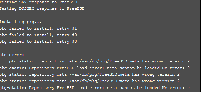

Getting a weird error when creating a plex jail. anyone else have this error?
Create the jail without trying to install any of the app part and then try
iocage exec jailname"mkdir -p /usr/local/etc/pkg/repos"
iocage exec jailname"nano /usr/local/etc/pkg/repos/FreeBSD.conf"
FreeBSD: {
    url: "pkg+http://pkg.FreeBSD.org/${ABI}/latest"
iocage exec jailname pkg upgrade
