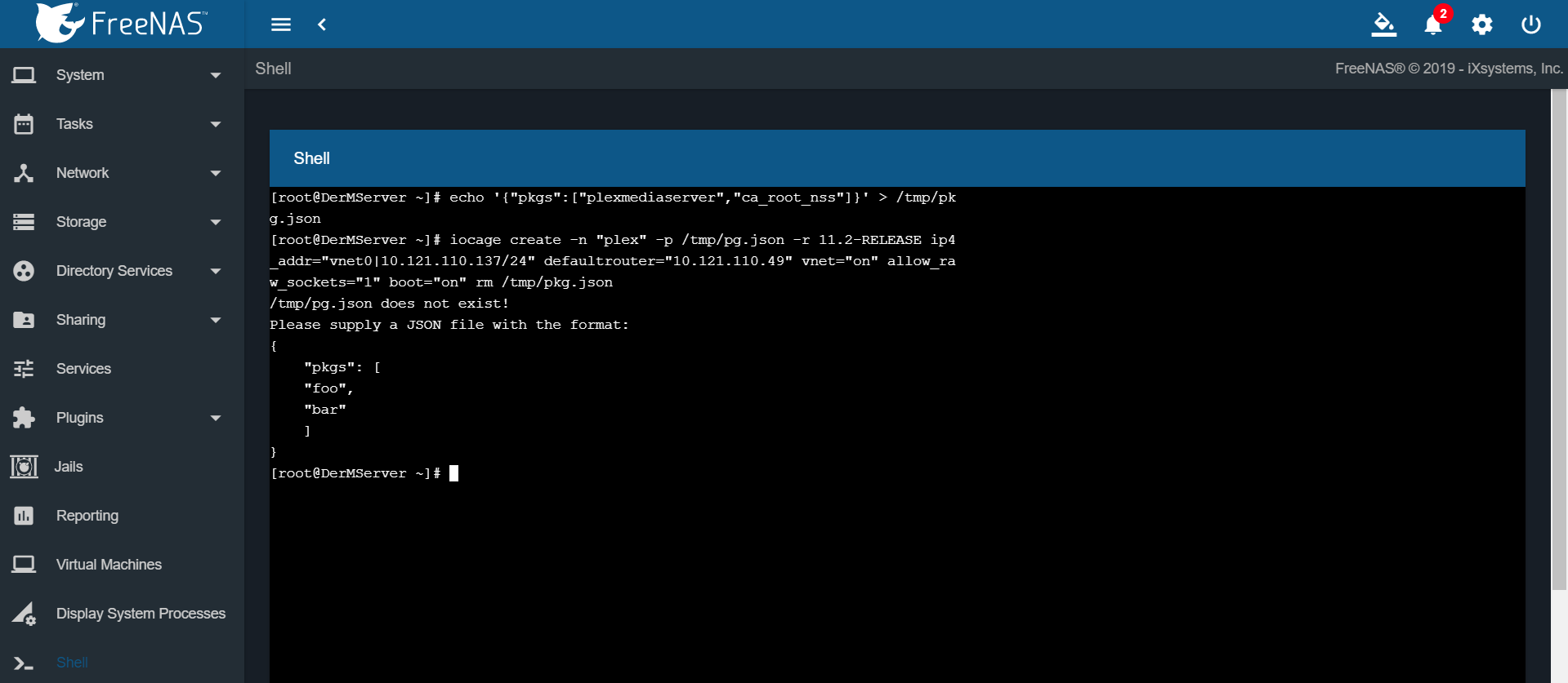

Hello, Im trying to use the shell to get Plex to work since I kept getting a vnet failure error when I followed the FreeNAS plugin install video.
After trying to complete the second line, im getting the following error message in the shell:
"Please supply a JSON file with the format:"
Any help would be much appreciated. For some reason it seems as though plex just doesnt want to be friends with me. lol

ThreeDee
Jun 13, 2013
700
I also had a question about the "iocage fstab -a plex /mnt/tank1/apps/plex /config nullfs rw 0 0 " line. Is the "/mnt/tank1..." supposed to be the volume you are using for your plex files? Just wondering because Im not sure if mine is supposed to be what is listed there or if it is supposed to be customized to my setup? When I setup the mount point through the Jails tab it is "/mnt/MyVolume/PlexMediaFiles"
Thanks again!
looks like you are in the "shell" of the main FreeNAS .. you have to create a Jail and access the shell of that jail inside of FreeNAS .. you might be better served to just install the Plex plug in though .. go to Plug ins .. and install whatever version of Plex you want to run (plex or plexpass)

00DerM
Apr 28, 2015
11
Thanks ThreeDee. Unfortunately when I try to install PLEX through the plugin it always give me a "Stopped plex due to VNET failure" error message and I cant seem to get past that so I tried to use this and its what several people have suggest. Any more help you could provide would be awesome! Thanks and have a blessed day!

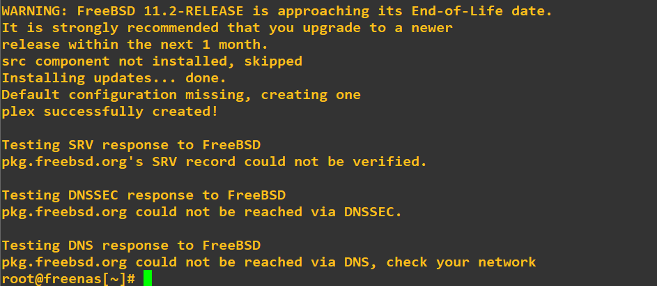

Need help with this plex-plexpass error. After performing the iocage create, it says plex was successful, then I get the errors in the image. I am running U5 of 11.2 and I can ping to outside networks.
Thanks

AirborneTrooper
Jun 20, 2014
148
Thanks
Are you doing the echo command and iocage command like the original instructions say besides using your own datasets instead of tank or whatever?
