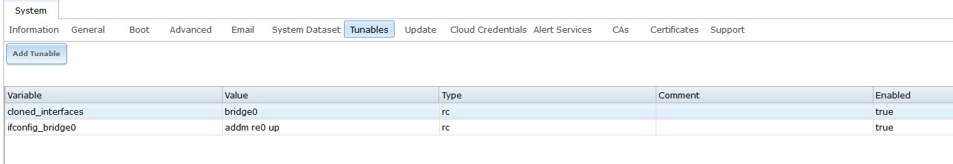

Laurence Milton
Apr 2, 2017
16
I am running FREENAS 11.1 Stable
I have successfully installed Plex and Sonarr under iocage and both are running fine. I have sabNZBD and Radarr running under the old Warden jails.
I am trying to set up Radarr under iocage but am having problems setting up the initial iocage jail for radarr. When I run:-
 iocage create -n "radarr" -p /tmp/pkg.json -r 11.1-RELEASE ip4_addr="vnet0|192.168.1.20/24>" defaultrouter="192.168.1.254" vnet="on" allow_raw_sockets="1" boot="on"
I get the dreaded message:- "Error: error sending query: Error creating socket"
I have read through all 24 pages of this thread and tried the suggested solutions including adding Tunables: - View attachment 24673
Unfortunately nothing seems to work.
Just wondering if there are any other suggestions of what I could try.
Thanks
