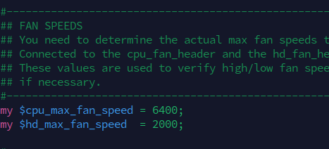

And in addition I have the two HD fans that are in the same Fan Zone (0) as the Exhaust fan, which is bigger, but have different max. speeds (2000 vs. 1300). What should I put in line 403?
You shouldn't really be mixing fans like that in the same zone... but ultimately, not including the lower speed one in the testing/reporting group would be the workaround.

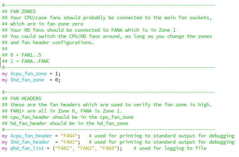

And then I named the fans here according to how they are called when I run "ipmitool sdr" in the SSH Terminal. Are the entries correctly made?

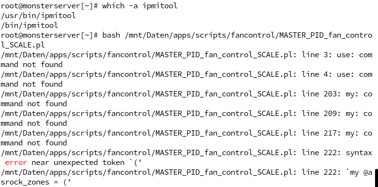

I used which command to find the ipmitool and used the /usr/bin/ipmitool path. However, when I try to run the script via bash, I get the following errors (since I have a Supermicro board should I delete the lines referring to ASRock?):

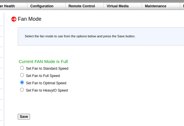

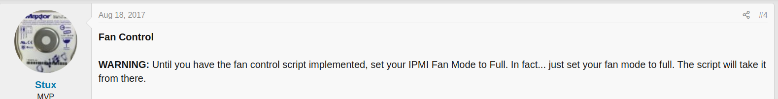

And last but not least, which setting should I use in IPMI itself?
I have now set it to Full because that was stux' original suggestion for his script:
Those lines shouldn't do any harm... not sure where the error is actually coming from there.
You're starting it with bash... is that really necessary?
That very well may be the the source of your errors .pl files are generally perl files which should be run as an independent executable not via bash (or any other shell interpreter). Without looking at the script and just your errors they are exactly what I would expect when bash tries to execute a perl script.

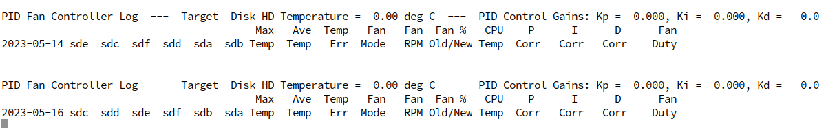

HI @sretalla, that looks like the same script I had used before. Any suggestions what to do next? It also seems that nothing gets logged correctly. Would it help if I put up my pl file?

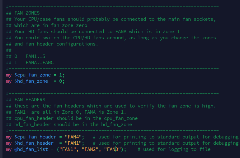

OK, so first obvious thing is that you've left influx logging enabled, but not changed the IP to one that makes sense to me... I guess you won't have an influxdb on your router (192.168.1.1... if that's even an address on your network at all).
I suggest changing line 255 to:
my $use_influx = 0;
On line 402, you've set your CPU fan speed to 6000... can that be right? Your fan must be able to hit that speed or the script will continually try to set it (and will fail).
On lines 448 - 450, you've got your fans set incorrectly... you need to read the instructions starting on line 428... the zones must be split, so you can't use FAN1 in zone 0 and FAN4 in zone 1, you need to use FANA instead.
Make sure you're not running the script via bash, just run the .pl directly and give it a test once you've corrected the above points.
According to the IPMI tests, it can even run 6200. It is the small fan just above the cooler on the CPU.
I have wired them like in the build from @Stux I referred to earlier in this post. I explained my setup in the first couple of lines. I got the CPU fan ganged off FAN4 which is in Fan Zone 1, all other three fans (FAN1, FAN2, FAN3) in Fan Zone 0. There is no FANA in my IPMI, I thought I had to use the namings of the fans as in my IPMI tool?!
After considering the question with regards to CPU fan speed (line 402) and the explanations on the different fan setup, I'm asking myself, what's determining what, i.e. is the cpu_max_fan_speed in line 402 dependent on cpu_fan_zone in line 438? Shouldn't I then first determine my fan zones, i.e. what belongs where and then provide inputs regardings speeds? The whole fan zone thing seems to me something that should come first and then all the stuff about speed etc. But maybe I am wrong, not an expert :) Or maybe it is all the different nomenclature. Best to define somewhere that, e.g. Fan Zone xyz is the CPU fan is FAN1 in IPMI and then just stick with FAN1. Just a suggestion but maybe I'm wrong since I am new to the perl-stuff :smile:
OK, fair. I have just taken the supermicro fan code from @Kevin Horton (who in turn took it from @Stux ), so I expect it's fine if you follow his recommendations.

Ok, but shouldn't I mention all fans in that section "$hd_fan_header" instead of just FAN1? Do I need to use semicolons? And with those changes made, shouldn't the script work?

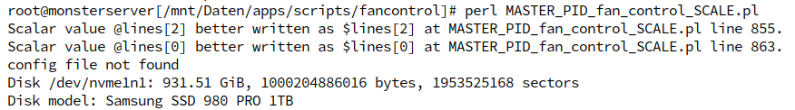

EDIT: I ran the script via the perl command and got some output but it is a bit cryptic to me. Right after the command comes this:
Is it referring to the config file with the number of warmest disks? Afterwards it shows me some smart test results from early on like 2020, is that expected?
And at the end this appears:
Use of uninitialized value $n in numeric gt (>) at MASTER_PID_fan_control_SCALE.pl line 978.
Use of uninitialized value $hd_num_peak in division (/) at MASTER_PID_fan_control_SCALE.pl line 982.
Illegal division by zero at MASTER_PID_fan_control_SCALE.pl line 982.
No, it's normal to just mention 1 to identify the "zone".
The other fans you want to capture for reporting of speeds are on the next line (including the first one).
it seems that file might have permissions issues or not exist?
Not sure what you mean... it might show the output of smartctl... that can have records of old tests in it.
That looks like it's including a disk which has no value in it... I notice it's talking about an NVME disk in the output above, it shouldn't really be used on NVME/SSD disks as their temperatures don't need the same control as HDDs. can you confirm what hardware you have in that box?
