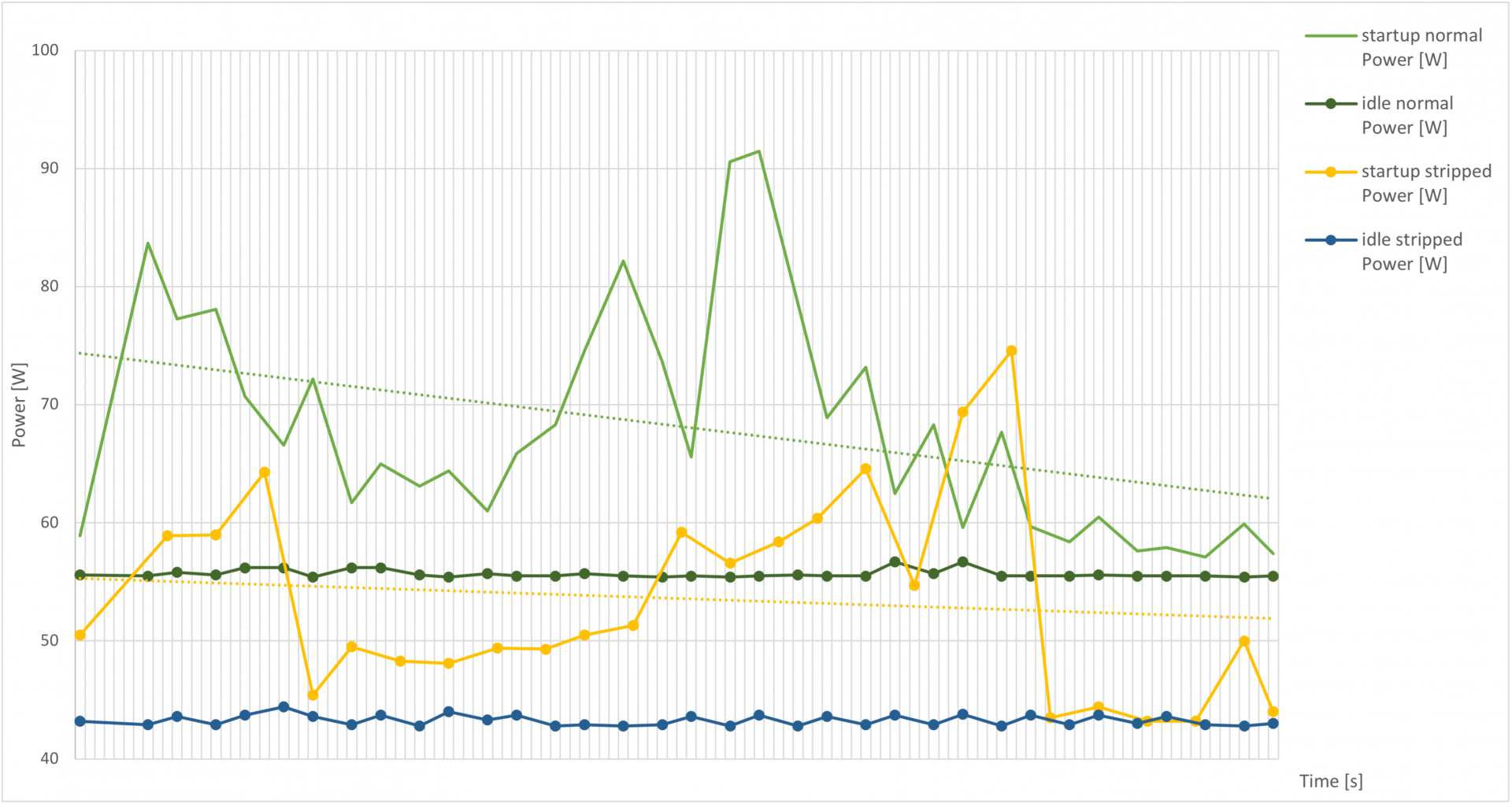

Update:
I stripped everything I could from the PC, all but one ram stick, the storage drives, external devices and the main system fan.
With everything installed I averaged 68.07 W on startup, and 55.67 W on idle. This went down to 53.49 W and 43.27 W respectively so it's clear that the CPU is responsible for most of the power usage.

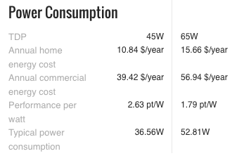

I found a comparison between the X2 250 and X4 610e, where a system with the X4 installed would consume an average of 16.25 W less. This leads me to believe that it wouldn't be unrealistic if my power consumption dropped down to 40-45 W (on idle) with everything installed. This is still a fair bit but with a 10 W power reduction, this would mean that I earn back the CPU cost in under 5 months. Assuming the system would be running full-time in both scenarios.
I think maybe I'll just buy the CPU and see if it works out, if Plex or MineOS performance is somehow much worse I'll just have to take that €7.80 loss. However, I doubt that it will be worse. Any final thoughts on this last matter would be appreciated though.
