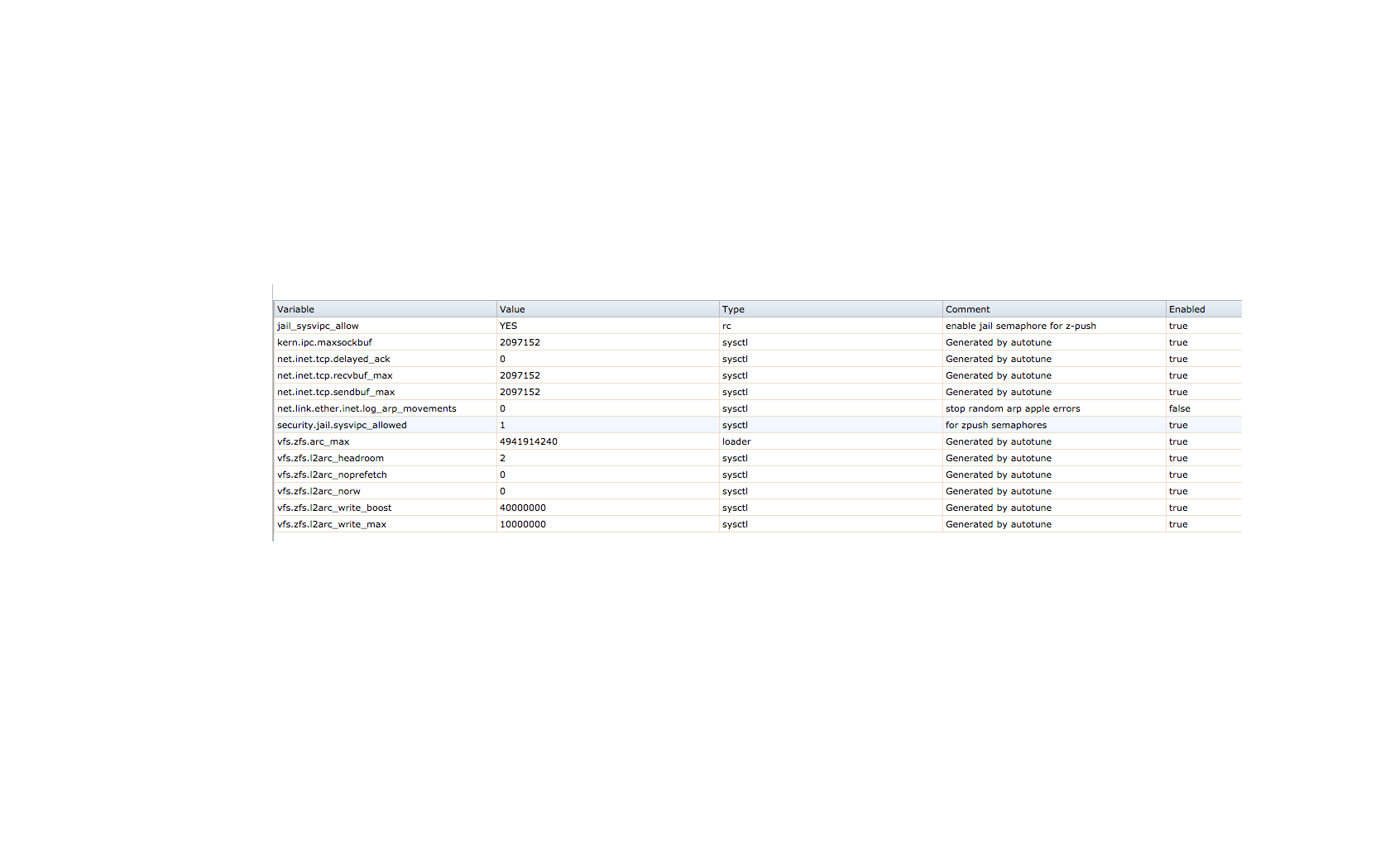

I have added the following 'tuneables' to freenas to try and sort out the situation
jail_sysvipc_allow="YES" (rc)
security.jail.sysvipc_allowed="1" (sysctl)
(see screenshot)
I then rebooted but that doesn't seem to enable semaphores.
What else do I need to do to enable semaphores? Why aren't they enabled in Jails by default?

Great! Adding allow.sysvipc=1 worked perfectly!!
Thank you very much!!
(well after I realised it was a comma delimited list rather than just add it on a separate line!!! Maybe this should be explicitly stated rather than hidden in the help box)
