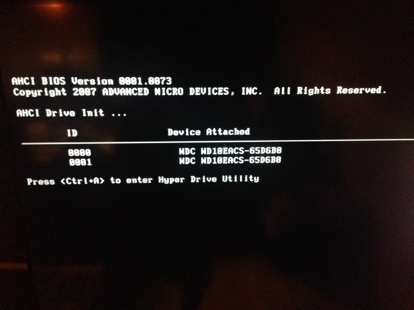

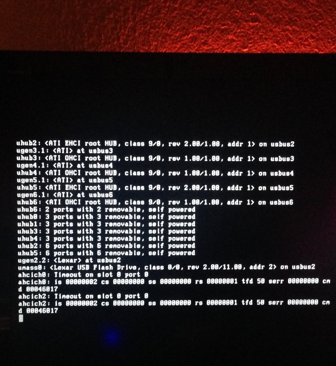

Hello,
my 2 SATA II Drives are visible in the BIOS, but when FreeNAS boots from the USB Stick, i get the follwing message and the drives are not shown. Only my cd drive and the usb stick where the IOS is running.
Hardware:
Mainboard: Gigabyte GA-MA78GM-S2H
RAM: 4GB
HDD: 2x WD 1TB
Thanks!

First, you need 8GB of RAM minimum just so that the WebGUI doesn't malfunction left and right.
Second, that error often is because your hard drive controllers aren't set to AHCI.

Thanks for your reply!
Ok, let me upgrade this for more performance, thanks!
But this should no problem for the volume issue?
Controller is set to AHCI (see Screenshot)
Do you got some more tips? :rolleyes:

WD EACS? Holy crap, those are ancient.
Can you try with different drives and/or validate that the current ones are working?

Doesn't explain the timeouts, though.
It could be that the USB/SATA bridge is masking the problem, somehow, making them look like they're working.

Jan 29 19:12:17 nas4free kernel: (aprobe0:ahcich0:0:15:0): NOP. ACB: 00 00 00 00 00 00 00 00 00 00 00 00
Jan 29 19:12:17 nas4free kernel: (aprobe0:ahcich0:0:15:0): CAM status: Command timeout
Jan 29 19:12:17 nas4free kernel: (aprobe0:ahcich0:0:15:0): Error 5, Retries exhausted
Jan 29 19:12:17 nas4free kernel: (aprobe1:ahcich2:0:15:0): NOP. ACB: 00 00 00 00 00 00 00 00 00 00 00 00
Jan 29 19:12:17 nas4free kernel: (aprobe1:ahcich2:0:15:0): CAM status: Command timeout
Jan 29 19:12:17 nas4free kernel: (aprobe1:ahcich2:0:15:0): Error 5, Retries exhausted

Jan 29 19:12:17 nas4free kernel: ahcich0: Timeout on slot 0 port 0
Jan 29 19:12:17 nas4free kernel: ahcich0: is 00000002 cs 00000000 ss 00000000 rs 00000001 tfd 50 serr 00000000 cmd 00046017
Jan 29 19:12:17 nas4free kernel: (aprobe0:ahcich0:0:0:0): ATA_IDENTIFY. ACB: ec 00 00 00 00 40 00 00 00 00 00 00
Jan 29 19:12:17 nas4free kernel: (aprobe0:ahcich0:0:0:0): CAM status: Command timeout
Jan 29 19:12:17 nas4free kernel: (aprobe0:ahcich0:0:0:0): Error 5, Retry was blocked
Jan 29 19:12:17 nas4free kernel: ahcich2: Timeout on slot 0 port 0
Jan 29 19:12:17 nas4free kernel: ahcich2: is 00000002 cs 00000000 ss 00000000 rs 00000001 tfd 50 serr 00000000 cmd 00046017
Jan 29 19:12:17 nas4free kernel: (aprobe1:ahcich2:0:0:0): ATA_IDENTIFY. ACB: ec 00 00 00 00 40 00 00 00 00 00 00
Jan 29 19:12:17 nas4free kernel: (aprobe1:ahcich2:0:0:0): CAM status: Command timeout
Jan 29 19:12:17 nas4free kernel: (aprobe1:ahcich2:0:0:0): Error 5, Retry was blocked
Jan 29 19:12:17 nas4free kernel: run_interrupt_driven_hooks: still waiting after 60 seconds for xpt_config

Jan 29 19:18:44 nas4free kernel: (aprobe0:ahcich0:0:15:0): NOP. ACB: 00 00 00 00 00 00 00 00 00 00 00 00
Jan 29 19:18:44 nas4free kernel: (aprobe0:ahcich0:0:15:0): CAM status: Command timeout
Jan 29 19:18:44 nas4free kernel: (aprobe0:ahcich0:0:15:0): Error 5, Retries exhausted
Jan 29 19:19:14 nas4free kernel: ahcich0: Timeout on slot 0 port 0
Jan 29 19:19:14 nas4free kernel: ahcich0: is 00000002 cs 00000000 ss 00000000 rs 00000001 tfd 50 serr 00000000 cmd 00046017
Jan 29 19:19:14 nas4free kernel: (aprobe0:ahcich0:0:0:0): ATA_IDENTIFY. ACB: ec 00 00 00 00 40 00 00 00 00 00 00
Jan 29 19:19:14 nas4free kernel: (aprobe0:ahcich0:0:0:0): CAM status: Command timeout
Jan 29 19:19:14 nas4free kernel: (aprobe0:ahcich0:0:0:0): Error 5, Retry was blocked
Jan 29 19:19:44 nas4free kernel: ahcich0: Timeout on slot 0 port 0
Jan 29 19:19:44 nas4free kernel: ahcich0: is 00000002 cs 00000000 ss 00000000 rs 00000001 tfd 50 serr 00000000 cmd 00046017
Jan 29 19:19:44 nas4free kernel: (aprobe0:ahcich0:0:0:0): ATA_IDENTIFY. ACB: ec 00 00 00 00 40 00 00 00 00 00 00
Jan 29 19:19:44 nas4free kernel: (aprobe0:ahcich0:0:0:0): CAM status: Command timeout
Jan 29 19:19:44 nas4free kernel: (aprobe0:ahcich0:0:0:0): Error 5, Retry was blocked
Jan 29 19:19:44 nas4free kernel: (aprobe0:ahcich2:0:15:0): NOP. ACB: 00 00 00 00 00 00 00 00 00 00 00 00
Jan 29 19:19:44 nas4free kernel: (aprobe0:ahcich2:0:15:0): CAM status: Command timeout
Jan 29 19:19:44 nas4free kernel: (aprobe0:ahcich2:0:15:0): Error 5, Retries exhausted
Jan 29 19:20:08 nas4free root: htpasswd service executed
Jan 29 19:20:14 nas4free kernel: ahcich2: Timeout on slot 0 port 0
Jan 29 19:20:14 nas4free kernel: ahcich2: is 00000002 cs 00000000 ss 00000000 rs 00000001 tfd 50 serr 00000000 cmd 00046017
Jan 29 19:20:14 nas4free kernel: (aprobe0:ahcich2:0:0:0): ATA_IDENTIFY. ACB: ec 00 00 00 00 40 00 00 00 00 00 00
Jan 29 19:20:14 nas4free kernel: (aprobe0:ahcich2:0:0:0): CAM status: Command timeout
Jan 29 19:20:14 nas4free kernel: (aprobe0:ahcich2:0:0:0): Error 5, Retry was blocked
Jan 29 19:20:44 nas4free kernel: ahcich2: Timeout on slot 0 port 0
Jan 29 19:20:44 nas4free kernel: ahcich2: is 00000002 cs 00000000 ss 00000000 rs 00000001 tfd 50 serr 00000000 cmd 00046017
Jan 29 19:20:44 nas4free kernel: (aprobe0:ahcich2:0:0:0): ATA_IDENTIFY. ACB: ec 00 00 00 00 40 00 00 00 00 00 00
Jan 29 19:20:44 nas4free kernel: (aprobe0:ahcich2:0:0:0): CAM status: Command timeout
Jan 29 19:20:44 nas4free kernel: (aprobe0:ahcich2:0:0:0): Error 5, Retry was blocked
