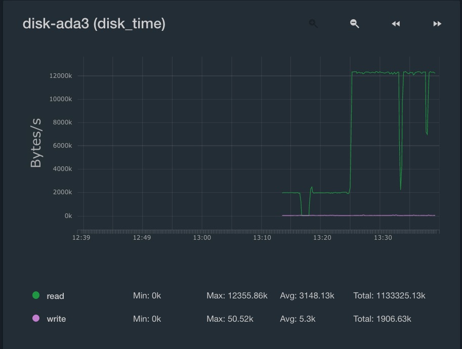

- As soon as the system is up, the 8TB goes into a solid/constant read state
- If I detach the pool, the light goes off. If I re-import the exiting 8TB pool, the read light goes on solid again.
- The other WD 3TB drives show normal/very low read rates in the "Reporting/Disk" graphics
- When the HGST 8TB pool is imported and active, the "Reporting/Disk" graph shows a maxed out read rate

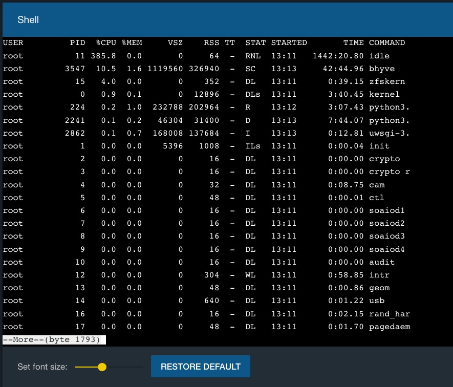

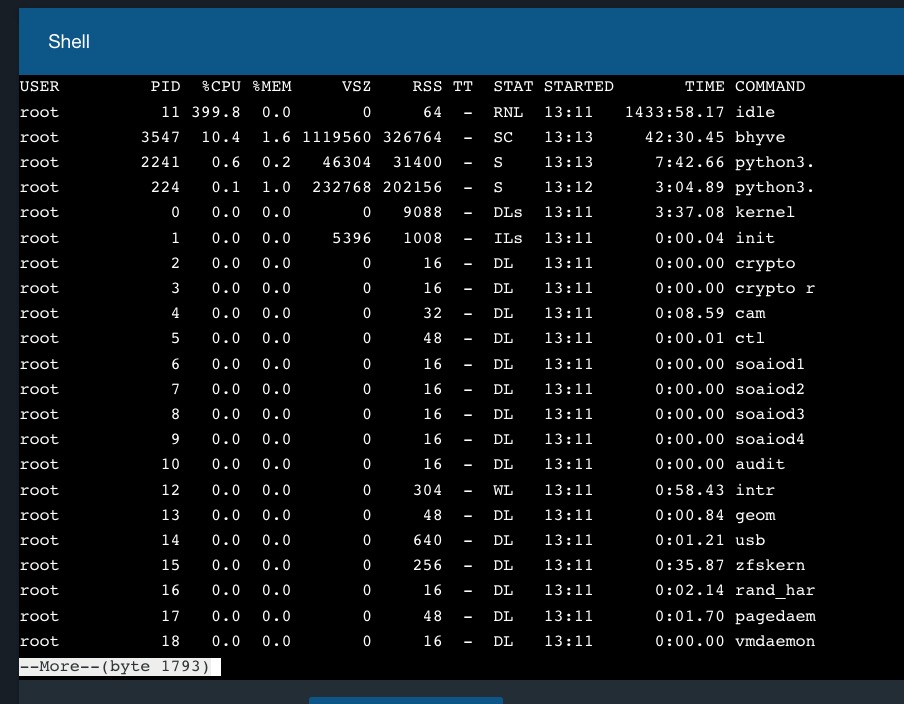

What's happening in top or ps -acux when the activity occurs? Also, anything being logged to /var/log/messages at that time?

Thanks for your reply, Ms. Lavigne... The first screen snap below is with the pool detached, the second is after it was imported and the read light was on solid. Looks like "zfskern" and "uwsgi-3" are the add'l processes? And here are the msgs from the interval. I did get one error when trying to re-detach the pool, presumably timing out from the constants reads on the drive?
