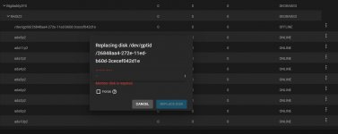

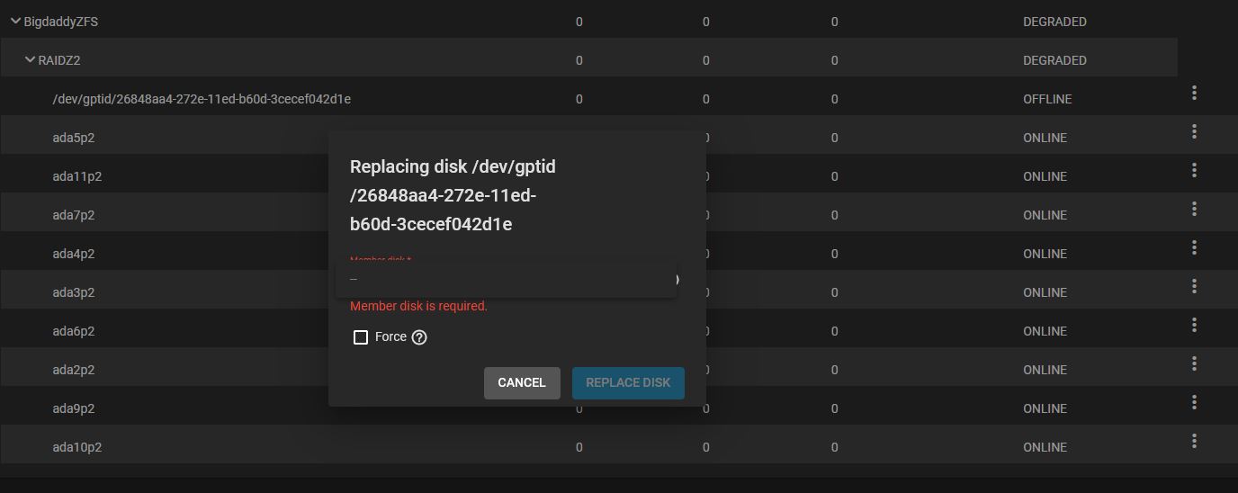

I have a 10 x 2TB RAIDZ2 pool and I had a drive in my pool fail, ada8. I swapped out the failed drive for a new one. Now when I go to replace disk the "member disk" list is blank. The disk I need to replace is ada8, but it is not listed. I don't know what to do from here.

I'd normally add the replacement drive to the machine, then select the faulty drive and replace. Then once complete, remove the faulty drive.
I wish I had done that. Perhaps I can go backwards. I will try. I am out of SATA ports but I could put it on USB3 and then move it to SATA after removing the bad drive.
I get the error below. I thought I might be able to replicate the drive even though it is degraded but I cannot.
libzfs.ZFSException: pool I/O is currently suspended

theaddies
Mar 28, 2015
105
I don't really know what I did, but I rebooted and it has now resilvered and appears to work.
