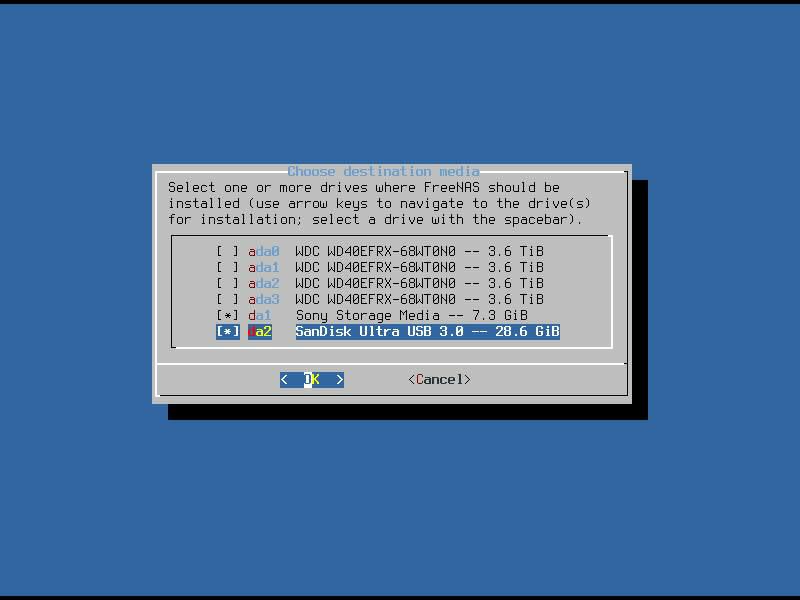

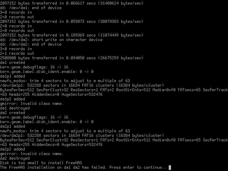

hi,
i'm trying to do a clean install on 2 thumb drive. they have been clean format with no partition. when i select both usb key and start the installation (either as UEFI or BIOS),
i get this error message
I know that my usb drive are not the same capacity, but for a clean install it should just pick the smaller size and make both drive THAT size.
what i am doing wrong

All well and good, but the absolute minimum size is 8 GiB. The Sony one is only 7.3, so you will need a larger module.
https://www.freenas.org/hardware-requirements/
actually the sony drive is the original drive which i used to run freenas from 9.10 to today 11.2-u2.1. FreeNAS was running just fine with that only sony thumb drive. now i just want to do a clean install so i can have mirror boot drive...
why in the first place freenas would let me install on that drive a few years ago... and let me upgrade to 11.2...

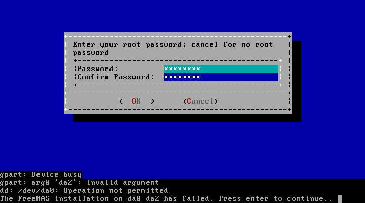

it work installing 9.10 on each usb key individually, but i can't get them to install both of it at the same time.

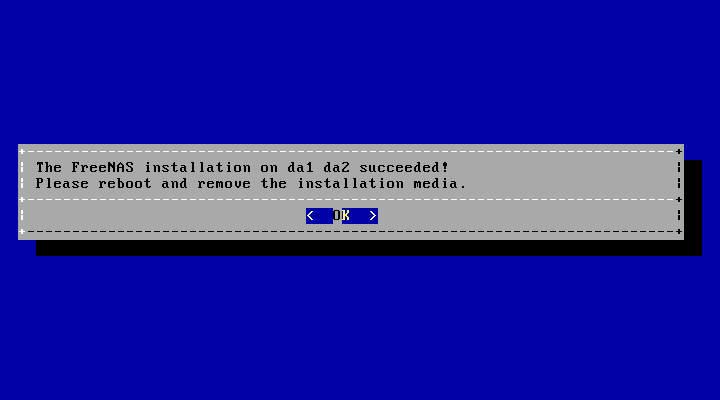

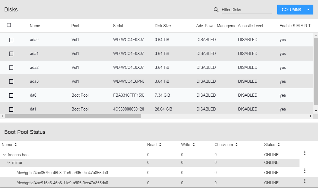

ok after literally 4 hours + of trying to install both drive at the same time i didn't change anything between the failures and that one time it work... don't know why. now i have to upgrade them to 11.2-u2.1.
update: that work...
