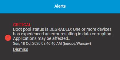

How can I check which disk or saw is damaged? Photo attached.
9,700
WD Green SSD - 240 GB - System
It's this one.
WD green is known to have the TRIM bug (at least under FreeNAS 11.3).
You should either select another SSD to use for boot or disable trim (unfortunately this is system-wide).

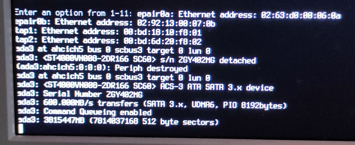

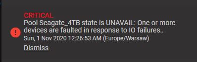

Now I have a problem with the Seagate drive. What can I do? Under windows, it shows that the disk is functional and that there are no bad sectors.
9,700
That looks like a physical disconnection... check your cabling/power to that disk.

joeschmuck
Old Man
May 28, 2011
10,996
All of your drives look fine except the Ironwolf drive has not completed an extended test, and you have a really weird mix of drives.
The only problem I see is you not finishing the SMART Extended tests on Seagate IronWolf ST4000VN008-2DR166, they keep getting interrupted, you likely keep turning off your system in the middle of the test. The values from all these drives are so different that I feel you have just shoved a bunch of various drives together, and there is nothing really wrong with it however most people would not configure a system that way which would mean that there has been very little testing of FreeNAS in this configuration.
You had something happen on your ExcelStor Technology J9250S drive about 59 hours of run time ago, but you also have a very high power cycle count, very odd.
Summary: Run SMART Extended test to a pass conclusion on the Ironwolf drive, if it passes then all looks good. Also, read the Hard Drive Troubleshooting Guide I put together, it's very helpful and does point out the key things to look for.

This is my smart test result. Is he good?

Model Family:     Seagate IronWolf
Device Model:     ST4000VN008-2DR166
LU WWN Device Id: 5 000c50 0b4bbf03d
Firmware Version: SC60
User Capacity:    4,000,787,030,016 bytes [4.00 TB]
Sector Sizes:     512 bytes logical, 4096 bytes physical
Rotation Rate:    5980 rpm
Form Factor:      3.5 inches
Device is:        In smartctl database [for details use: -P show]
ATA Version is:   ACS-3 T13/2161-D revision 5
SATA Version is:  SATA 3.1, 6.0 Gb/s (current: 6.0 Gb/s)
Local Time is:    Wed Nov  4 20:57:13 2020 CET
SMART support is: Enabled
General SMART Values:
Offline data collection status:  (0x82) Offline data collection activity
                                        was completed without error.
Self-test execution status:      (   0) The previous self-test routine completed
                                        been run.
data collection:                (  591) seconds.
capabilities:                    (0x7b) SMART execute Offline immediate.
                                        command.
                                        Self-test supported.
SMART capabilities:            (0x0003) Saves SMART data before entering
                                        power-saving mode.
Error logging capability:        (0x01) Error logging supported.
Short self-test routine
recommended polling time:        (   1) minutes.
Extended self-test routine
recommended polling time:        ( 612) minutes.
Conveyance self-test routine
recommended polling time:        (   2) minutes.
SCT capabilities:              (0x50bd) SCT Status supported.
                                        SCT Data Table supported.
SMART Attributes Data Structure revision number: 10
  1 Raw_Read_Error_Rate     0x000f   084   064   044    Pre-fail  Always       -       0
  3 Spin_Up_Time            0x0003   095   093   000    Pre-fail  Always       -       0
  4 Start_Stop_Count        0x0032   100   100   020    Old_age   Always       -       100
  5 Reallocated_Sector_Ct   0x0033   100   100   010    Pre-fail  Always       -       0
  7 Seek_Error_Rate         0x000f   084   060   045    Pre-fail  Always       -       0
  9 Power_On_Hours          0x0032   085   085   000    Old_age   Always       -       13709 (54 144 0)
 10 Spin_Retry_Count        0x0013   100   100   097    Pre-fail  Always       -       0
 12 Power_Cycle_Count       0x0032   100   100   020    Old_age   Always       -       80
184 End-to-End_Error        0x0032   100   100   099    Old_age   Always       -       0
187 Reported_Uncorrect      0x0032   100   100   000    Old_age   Always       -       0
188 Command_Timeout         0x0032   100   100   000    Old_age   Always       -       0
189 High_Fly_Writes         0x003a   100   100   000    Old_age   Always       -       0
190 Airflow_Temperature_Cel 0x0022   074   060   040    Old_age   Always       -       26 (Min/Max 24/28)
191 G-Sense_Error_Rate      0x0032   100   100   000    Old_age   Always       -       0
192 Power-Off_Retract_Count 0x0032   100   100   000    Old_age   Always       -       62
193 Load_Cycle_Count        0x0032   100   100   000    Old_age   Always       -       297
194 Temperature_Celsius     0x0022   026   040   000    Old_age   Always       -       26 (0 19 0 0 0)
197 Current_Pending_Sector  0x0012   100   100   000    Old_age   Always       -       0
198 Offline_Uncorrectable   0x0010   100   100   000    Old_age   Offline      -       0
199 UDMA_CRC_Error_Count    0x003e   200   200   000    Old_age   Always       -       0
240 Head_Flying_Hours       0x0000   100   253   000    Old_age   Offline      -       13689 (98 93 0)
241 Total_LBAs_Written      0x0000   100   253   000    Old_age   Offline      -       25200339434
242 Total_LBAs_Read         0x0000   100   253   000    Old_age   Offline      -       47693418568
SMART Error Log Version: 1
No Errors Logged
# 1  Extended offline    Completed without error       00%     13704         -
# 2  Extended offline    Completed without error       00%     13680         -
# 3  Short offline       Completed without error       00%     13617         -
# 4  Short offline       Interrupted (host reset)      00%     13617         -
# 5  Short offline       Completed without error       00%     12791         -
# 6  Extended offline    Interrupted (host reset)      90%     12659         -
# 7  Extended offline    Aborted by host               90%     12658         -
# 8  Short offline       Completed without error       00%     12627         -
# 9  Short offline       Completed without error       00%     12459         -
#10  Short offline       Completed without error       00%     12291         -
#11  Short offline       Completed without error       00%     12137         -
#12  Short offline       Completed without error       00%     11969         -
#13  Short offline       Completed without error       00%     11801         -
#14  Short offline       Completed without error       00%     11636         -
#15  Short offline       Completed without error       00%     11468         -
#16  Short offline       Completed without error       00%     11300         -
#17  Short offline       Completed without error       00%     11132         -
#18  Short offline       Completed without error       00%     10964         -
#19  Short offline       Completed without error       00%     10796         -
#20  Short offline       Completed without error       00%     10628         -
#21  Short offline       Completed without error       00%     10460         -
root@dom[~]#
joeschmuck
Old Man
May 28, 2011
10,996
That drive looks fine.
