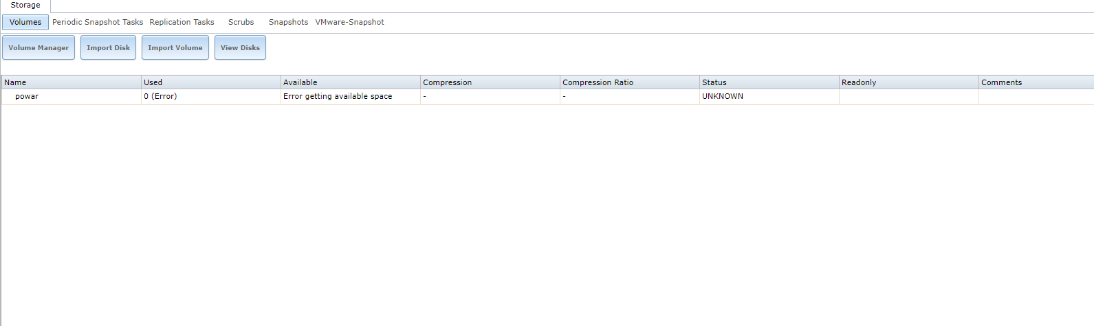

No , there was nothing in Volume Manager , i turned off the computer and now when i turned it on i saw something on screen saying : " cannot import " powar " one or more devices is currently unavailable
cannot open "powar" : no such pool"
Powar used to be the nickname for the hard drive

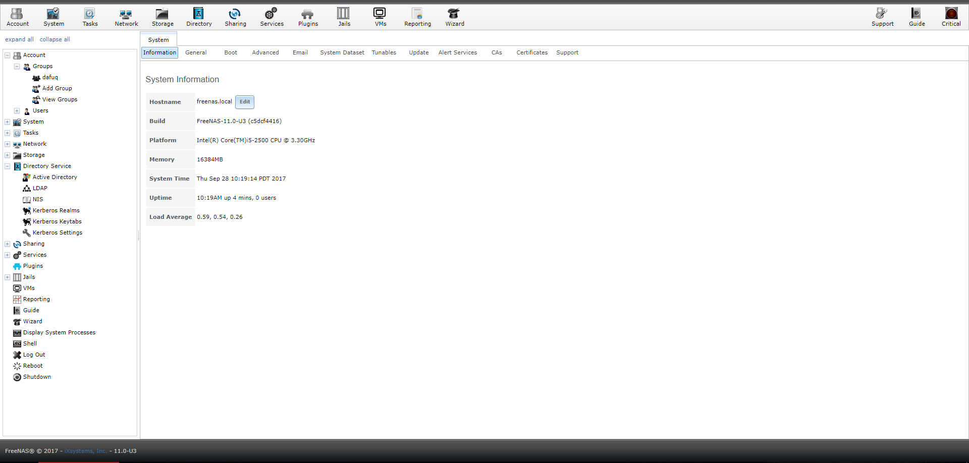

Now i turned on the computer but when i go into 192.168.0.105 i logged in and it's stuck in like "Loading"

dafuqqi
Sep 27, 2017
22
Now it looks like this but why ?

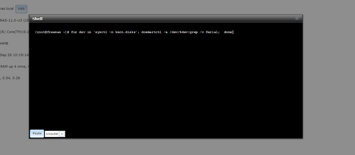

Can you go to a shell prompt and type the following:
bash
for dev in `sysctl -n kern.disks`; do smartctl -a /dev/$dev|grep -v Serial; done
Please paste the output in between CODE tags.
dafuqqi
Sep 27, 2017
22
Ok , i'll try that when i get at home and i'll post here the results , thanks for the help !

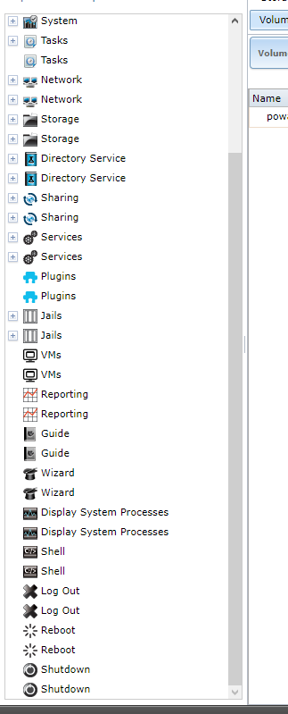

dafuqqi
Sep 27, 2017
22
The WebGui even the computer connected via HDMI into a display it's working very laggy ... what should I do ? I'm trying right now to do that command in shell but ... very hard
styno
Apr 11, 2016
466
Go to 'services' and activate ssh. Hopefully connecting via ssh will be doable.
Some comments on your screenshots:
1. first command you type is 'bash' then enter and the next command on the next line.
2. type it correctly, you are missing spaces.
3. there is a -paste- button, use it... (as in copy from the forum, paste in the shell)

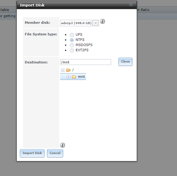

And the Critical button is light up and it's saying => CRITICAL: Sept. 28, 2017, 10:35 a.m. - The volume powar state is UNKNOWN:
Powar used to be the name of my main volume with data
I've checked the "Import Disk" function and it seems like might work , check picture below now i have a folder , should I try to import the disk ?
styno
Apr 11, 2016
466
That is not the complete output of that command, but from what you've pasted it looks like your disks are dying...

  4 Start_Stop_Count		0x0032   094   094   000	Old_age   Always	   -	   6276
  5 Reallocated_Sector_Ct   0x0033   200   200   140	Pre-fail  Always	   -	   0
  7 Seek_Error_Rate		 0x002e   200   200   000	Old_age   Always	   -	   0
  9 Power_On_Hours		  0x0032   084   084   000	Old_age   Always	   -	   11887
10 Spin_Retry_Count		0x0032   100   100   000	Old_age   Always	   -	   0
11 Calibration_Retry_Count 0x0032   100   100   000	Old_age   Always	   -	   0
12 Power_Cycle_Count	   0x0032   096   096   000	Old_age   Always	   -	   4878
191 G-Sense_Error_Rate	  0x0032   001   001   000	Old_age   Always	   -	   2690
192 Power-Off_Retract_Count 0x0032   200   200   000	Old_age   Always	   -	   362
193 Load_Cycle_Count		0x0032   168   168   000	Old_age   Always	   -	   98098
194 Temperature_Celsius	 0x0022   103   086   000	Old_age   Always	   -	   44
196 Reallocated_Event_Count 0x0032   200   200   000	Old_age   Always	   -	   0
197 Current_Pending_Sector  0x0032   200   200   000	Old_age   Always	   -	   0
198 Offline_Uncorrectable   0x0030   100   253   000	Old_age   Offline	  -	   0
199 UDMA_CRC_Error_Count	0x0032   200   200   000	Old_age   Always	   -	   0
200 Multi_Zone_Error_Rate   0x0008   100   253   000	Old_age   Offline	  -	   0
240 Head_Flying_Hours	   0x0032   089   089   000	Old_age   Always	   -	   8484
241 Total_LBAs_Written	  0x0032   200   200   000	Old_age   Always	   -	   13836532287
242 Total_LBAs_Read		 0x0032   200   200   000	Old_age   Always	   -	   13308943829
254 Free_Fall_Sensor		0x0032   200   200   000	Old_age   Always	   -	   0
[root@freenas ~]#
