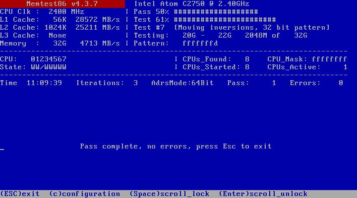

I've been running memtest on the machine for over a full day now, but it hasn't turned up anything yet. Memtest even says "nothing found, press escape to exit" but I'll keep it running for a bit longer. I've attached a screenshot from this morning (now over 24h and nothing changed).

That's what I'm currently doing. Kept running memtest, but still no errors.

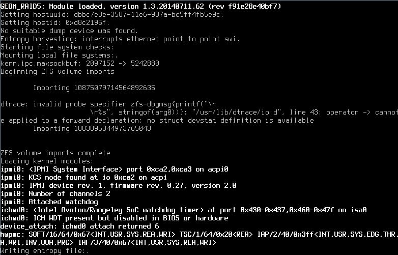

Got a weird warning when importing my zpool (attached), but I don't notice anything wrong. zpool status shows no problems.
