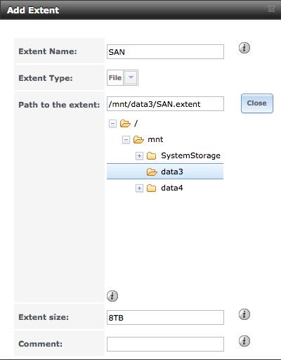

I've managed to create a device extent for use in FC target mode, worked well, fairly simple to set up once I got my head around concepts etc...
I'd like to create a file extent in seeing how well they work. Based on what I've read, they provide greater flexibility and more efficiency in terms of resource allocation.
However for the life of me I cannot seem to create a file extent on a volume or a data set.
I'm reading and following the 9.2.1 manual pages 192-193 section 8.7.2.1 and following tables 8.7b and 8.7c, the web site version seems to follow the manual word for word on this topic as well.
My RaidZ2 volume is 10.7TB and I've specified 8TB as a file extent size as I wish to stay within 80% usage. Plus I like round even numbers :)
Attached is a pic of what I've done in creating a file extent on top of a volume.
Below are the log messages resulting from trying to start the iSCSI service;
notifier: ctld: error returned from LUN creation request: ctl_be_block_open: error opening /mnt/data3/san.extent
ctld[19851]: error returned from LUN creation request: ctl_be_block_open: error opening /mnt/data3/san.extent
I was under the impression that when specifying a file extent name and its size, that this file would automatically get created. When would it get created, ie; what kicks off the file creation process?
And words of wisdom are appreciated.

I sat on this a bit and will instead dd a file of 8TB and use that for my file extent.

I ended up creating a file via dd /dev/zero being ~80% in size of my ZFS dataset. And using that as my file extent.

Yes, I have removed my post because I do not feel yet that I can give any recommendations on how to work with the freeNAS. I am new to freeNAS, freeBSD and ZFS. I was on OpenFiler but it seems this project is not developed anymore, so I decided to switch to freeNAS but have a lot of questions and doubts about using it in production environment. Regarding your question about a File extent, I was able to create a file extent yesterday but today all my attempts failed. That is why I can't give any advise on this subject. What I did as a workaround:
1. Stopped iSCSI service
2. from Shell: truncate -s +500g /mnt/ZFSVOL1/dataset1vol1/mysan. It will create a new file 'mysan'.
3. In GUI, created a new extent with the name 'mysan', selected existing /mnt/ZFSVOL1/dataset1vol1/mysan and set the size to 0.
4. from Shell: ls -lh /mnt/ZFSVOL1/dataset1vol1, mysan size is 500GB.
5. Started iSCSI service
Regards.

I figured out that those file extent files are created only after some target is associated with the file extent. It all makes sense now.
