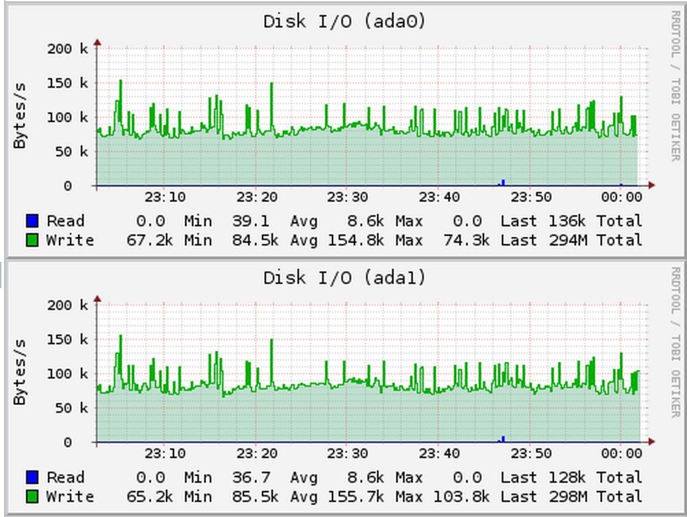

Ok two things here, first I seem to be having constant disk writes to my drives, yet I am not copying anything to the NAS and havent done all day?

The disk activity is completely normal, assuming your .system dataset is on your pool.
I can't explain why you aren't getting the temperature warning emails. Do you receive regular security run output emails?

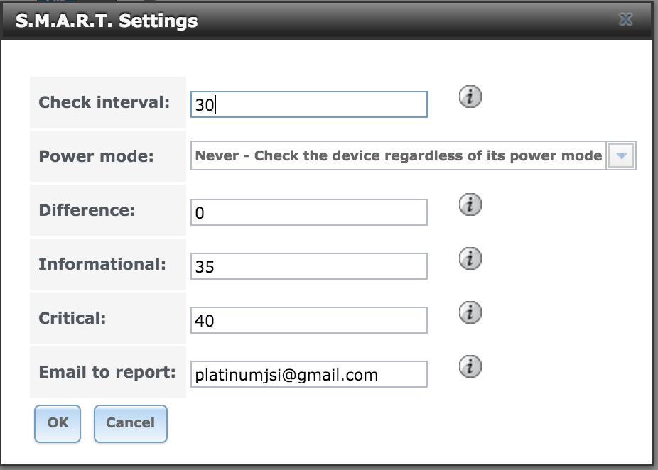

Screenshot of my settings

Bidule0hm
Server Electronics Sorcerer
Aug 5, 2013
3,710
We know from real world data than past 40 °C the failure rates sky rocket whatever the drive operating range temp is, see the google paper on this subject.
It's not a settings problem, it's a bug, please read the other thread.
