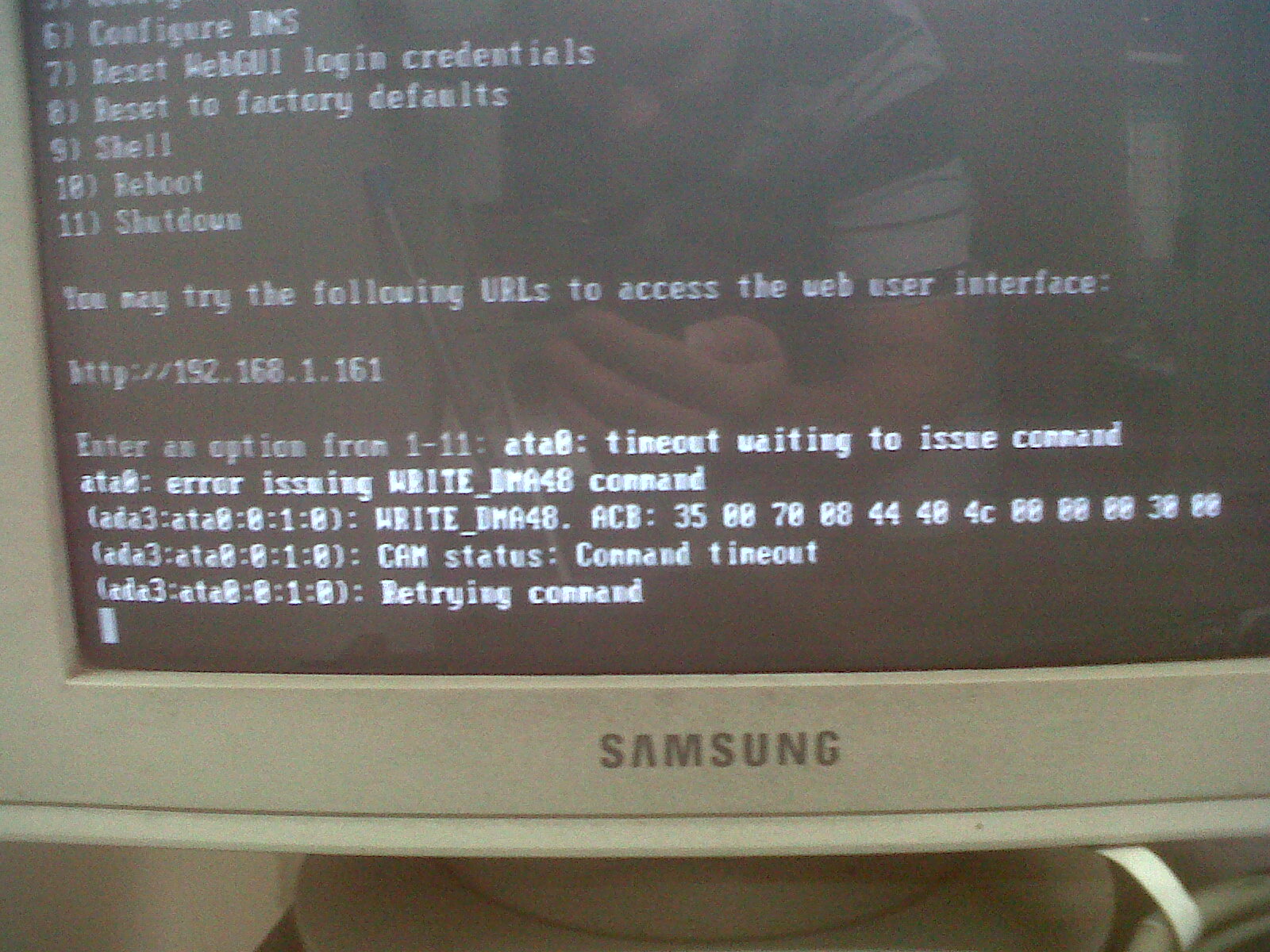

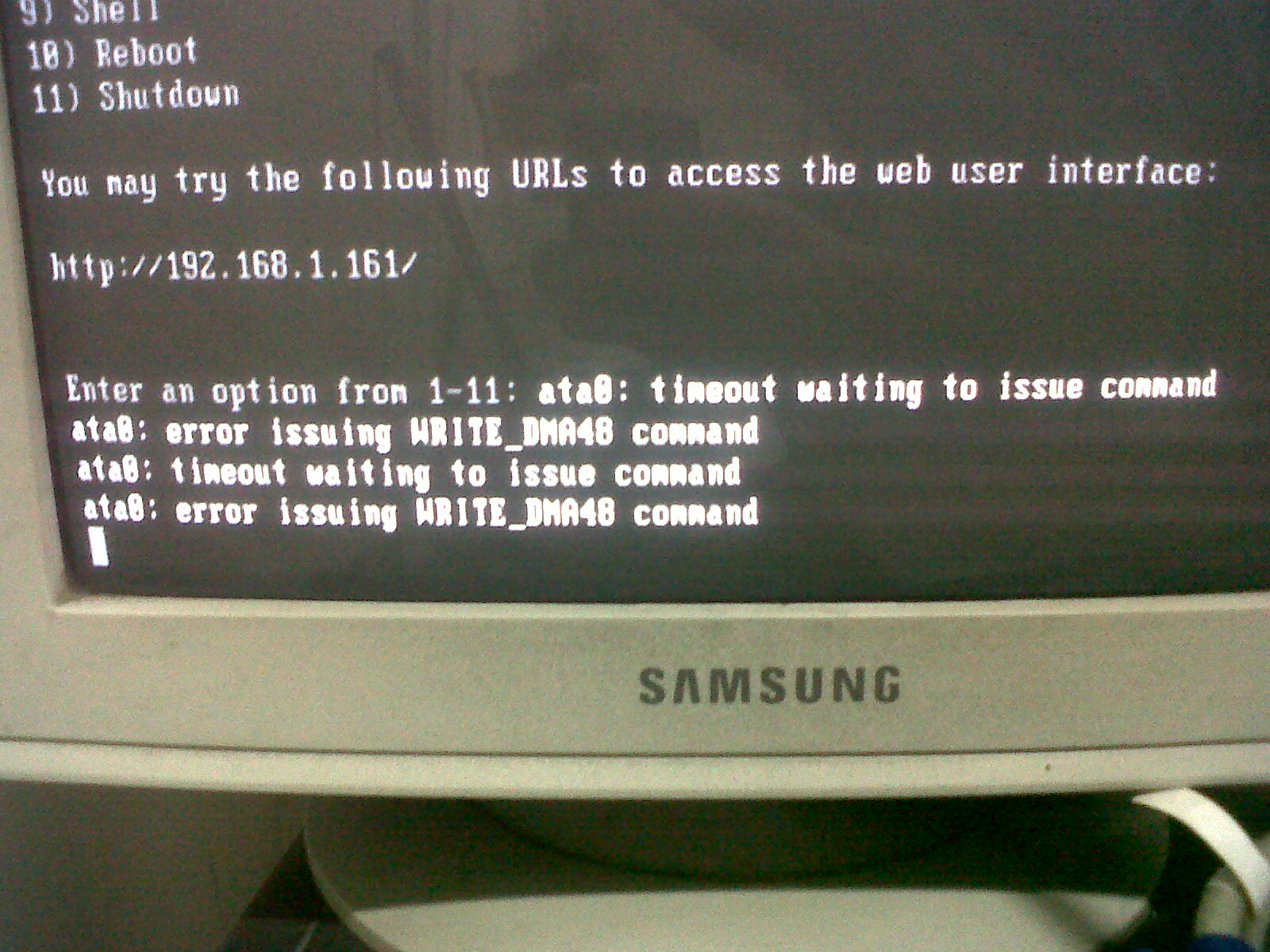

Hello, good morning, I have a server with Freenas 8.3.0. rigid six-disc 2 tb. The system works ok, ok record shows health status. But prints text to the console as the picture attached.
They thought that it may be?
From already thank you very much

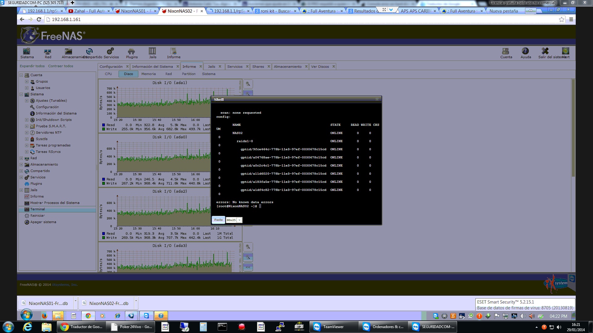

Is this UFS or ZFS? Hardware or software RAID? What type of RAID?
D
dlavigne
Guest
What is the output of "zpool status"? (post the whole thing between code tags)
