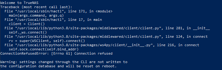

Hi! I was just adding another vdev to my pool and checked on ahead for the cloud sync task and did nothing as I was watching something. Suddenly, I got "Connecting to TrueNas... Make sure the TrueNas is powered on". I can't access the webgui however I could ssh into it.

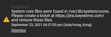

Okay so i restarted and somehow, I was recommended to send a ticket to jira. Do I remove "python3.8.core" from the "cores" destination?
You can after you did what you wanted to do regarding submitting the jira ticket.
Instead of a reboot, you probably could have restarted the middleware:
service middlewared restart
Oh didn't know that lmao, I wanted to send them the .core file but idk how since i dont have permission through smb. Would it be good to upgrade to U5? TrueNas version is currently 12.0U2.
