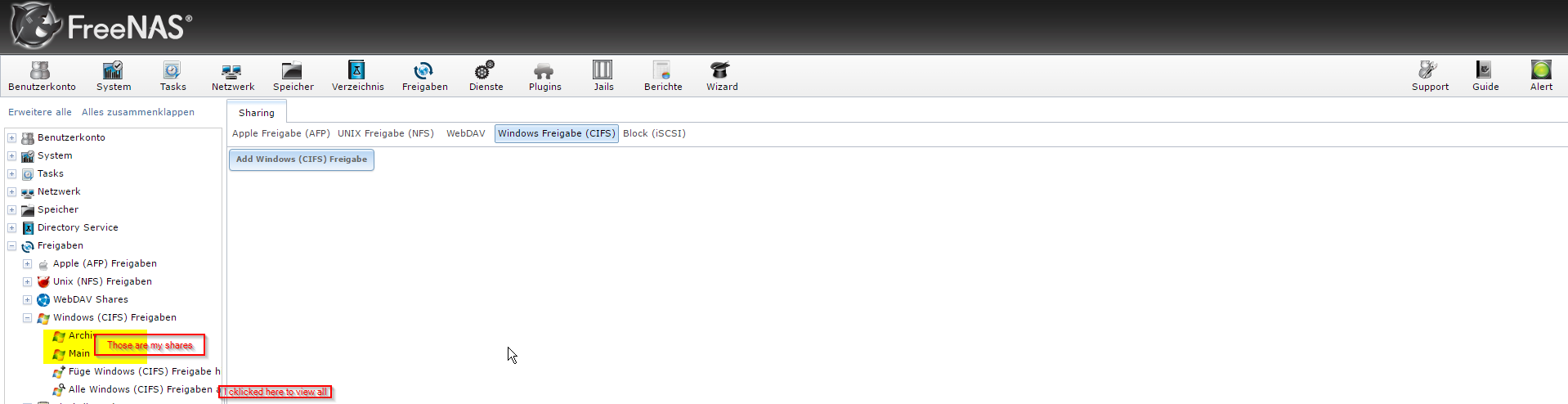

I'm perhaps misunderstanding you. Post a screenshot of "Sharing" -> "Windows (CIFS) Shares" -> "View Windows (CIFS) Shares" from the FreeNAS webgui.
I just found out that my sahre show up in the menu on the left site, but not in the overview. I Usually only use the top menu. But still the shares should show up or not?
Jaersi
May 1, 2016
5
ok I think I have a different problem.
I just tried to access the share from a different PC and it works just fine. So I have 2 PCs (Win 10 and Win 7) which can't connect to my NAS and one Win 8.1 machine which connects just fine.
Oh I love this!
Sorry for the confusion, I think I will start to clear my shares like you suggested. Hopefully that helps.
