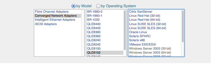

I am not sure the Qlogic cards have FreeBSD support, i know when i went looking for my Qlogic cards QLE3142 they were supported by FreeNAS so i went with a Chelsio T420-CR. According to Qlogics website for that adapter it does not show a FreeBSD driver...
