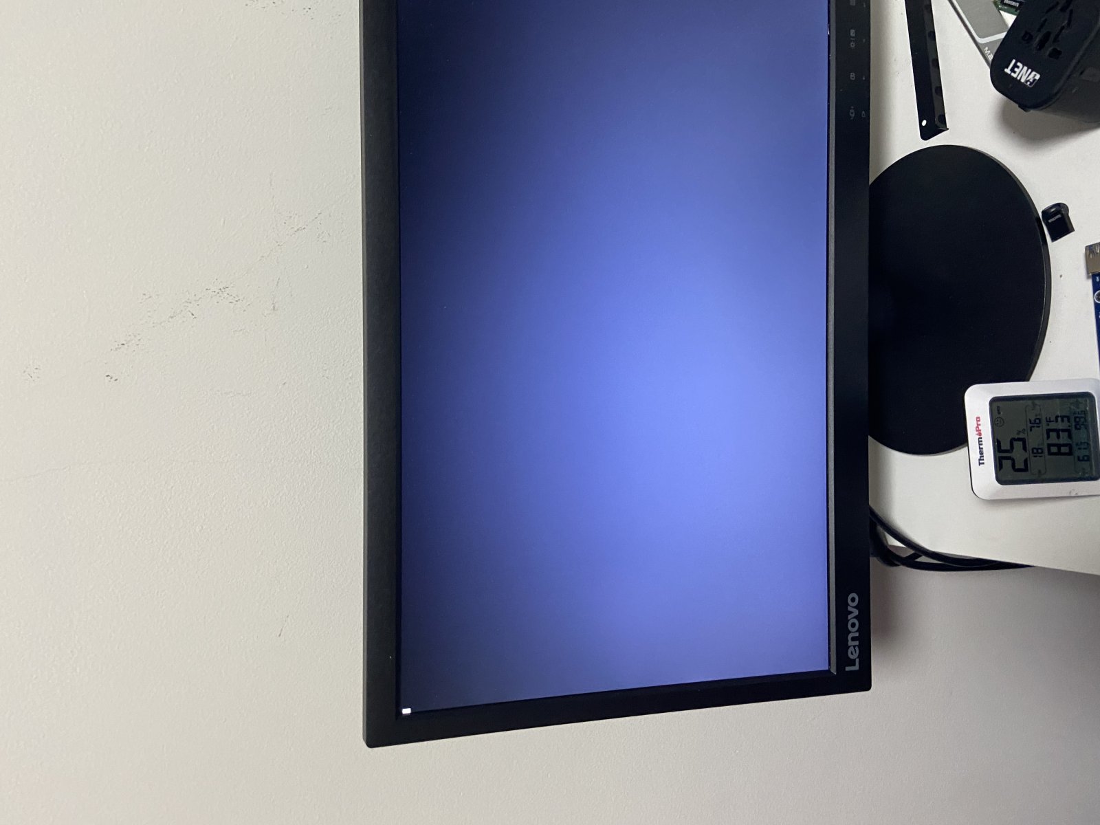

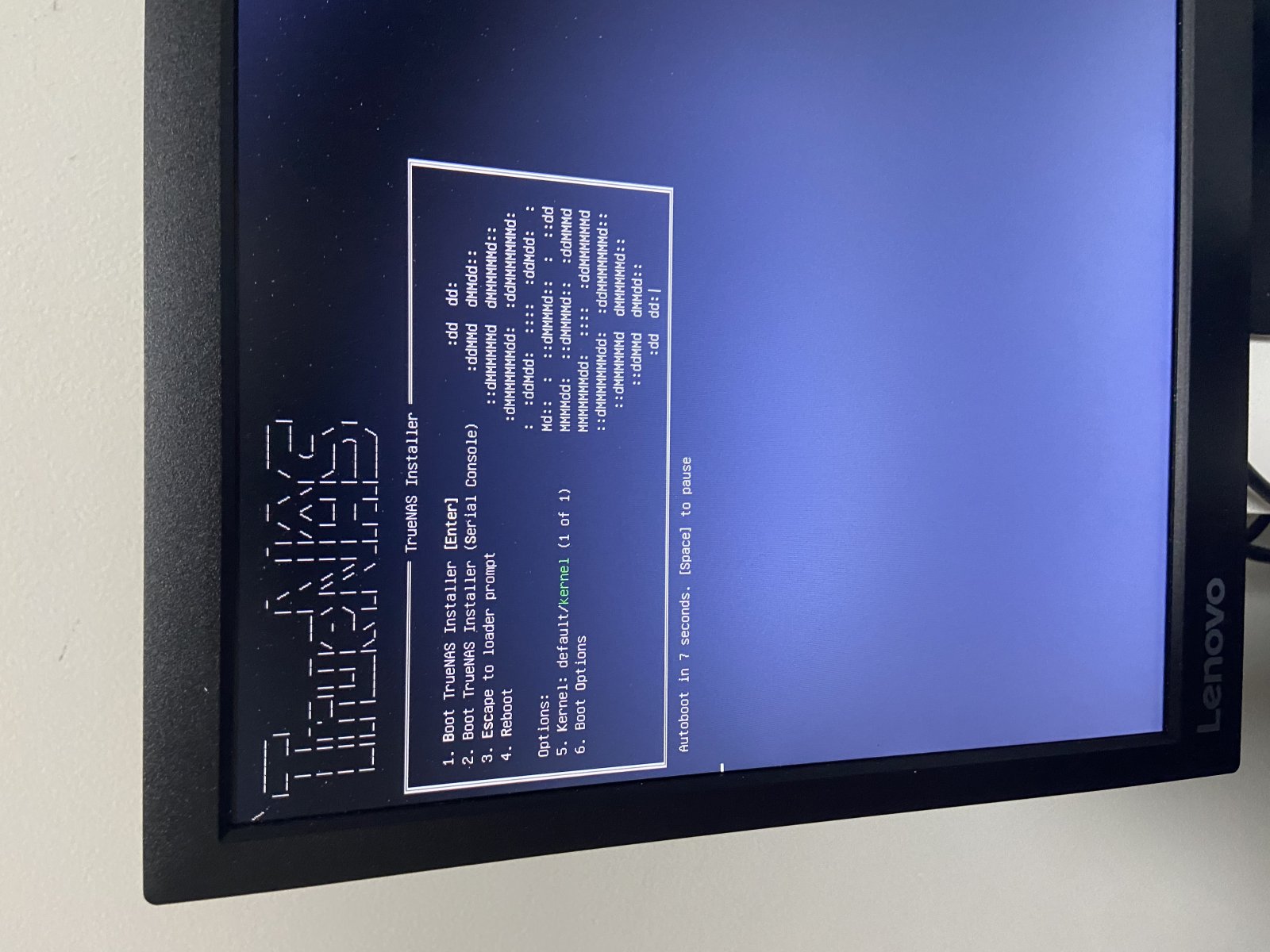

flashed usb as per all instructions, boots to install screen for options, once I select install (option 1 ) screen goes black with a stuck cursor on screen , nothing else. i have istalled truenas / freenas before. I just dont understand what the issue may be.

I have this exact same problem. Same specs except I have 64GB ram. I was however able to successfully install Truenas Scale without any issue. I played with it for a bit and then tried to install truenas core and get the same issue where I get the install prompt and then it goes straight to a black screen with a white block in the top left corner. Still have no idea what is going on.

still the same result press 1 then screen goes black. solid white cursor appears top left. keyboard flashes then nothing moves. PC is not hard locked as num lock and caps lock still respond and i can CTRL+ALT+DEL and force a reboot
