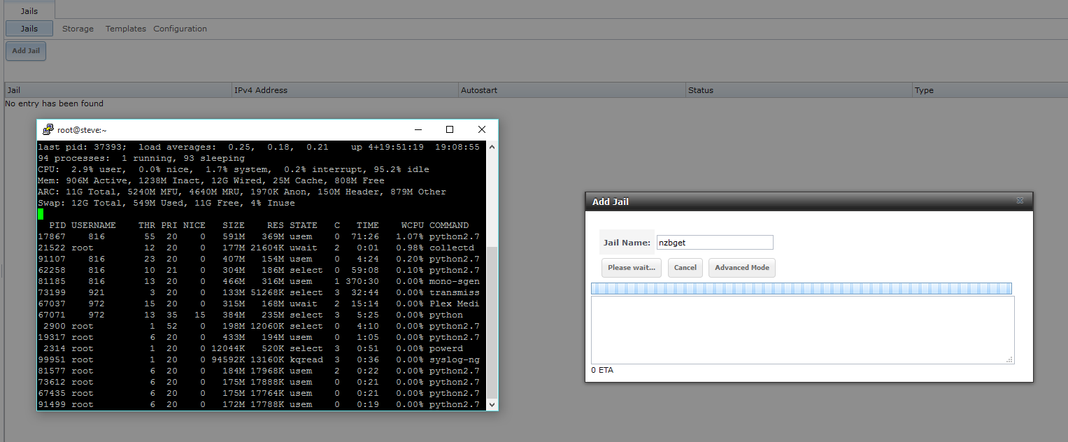

I'm getting "unable to find template" whenever I try to create a jail from the web GUI. I have searched and seen that this seems to be a fairly common problem with lots of different causes thanks to the unhelpful message.
Most of the answers I've seen for this is "your nas is not connected to the internet" but mine is, and my problem is whenever I try to create a template it will actually download the template completely then once it's downloaded it just says "unable to find template".

After creating the jail I'm unable to start it from the web GUI. It says it starts successfully but the status says "stopped" and jls doesn't show that it is running. I also can't start it with warden:

Right, sorry, forgot about all that. Updated OP with more info of my system.
I tried doing as you said, it looks like the jail download stalled:
I've noticed in the past that there's a bsdtar process that spawns when I start creating a jail and it downloads the template. No such luck with this time, and there was zero activity over my wan interface so it seems something hung or broke silently.
EDIT: Ok so I changed my configuration back and changed permissions on my datasets to 755 as the others all were and tried again. Same thing happened. Immediately afterwards I saved the debug information again and started looking through everything, and in debug.log I found this:
extract-tarball: Houston! We have a problem!
mtree: line 28596 too long
ERROR: mtree failed for /mnt/storage/jails/.warden-files-cache/mtree/freenas-standard-9.3-RELEASE.mtree
cannot open 'storage/jails/.warden-template-standard': dataset does not exist
find: /mnt/storage/jails/.warden-template-standard: No such file or directory
ERROR: Failed to create ZFS base dataset
So I pulled the mtree and went to line 28596 and saw that the hash is actually shorter than everything else in it:
Line 28596 also happens to be the very last line in the file.
I'm going to try remove this mtree and redownload and see how it behaves.
