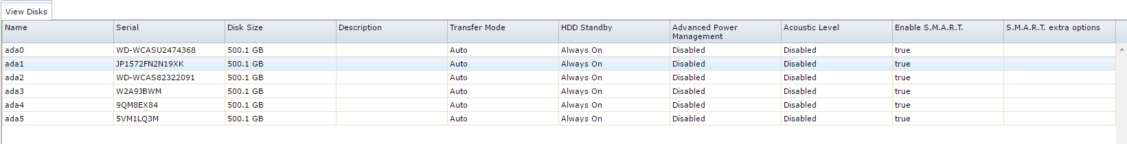

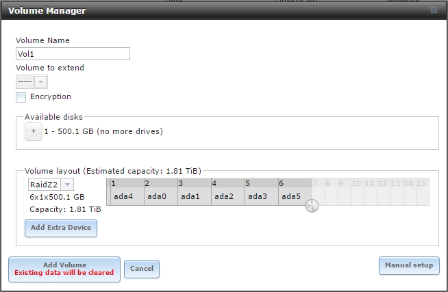

This is my first time setting up a FreeNAS system and can't seem to get a volume created.
I have 6x500gb disks and intend to use Raid-Z2. The initial setup wizard only sees 5 drives (ada0,1,2,3,5). If I go to View Disks, all drives are there (I quick wiped them all) and when I use Volume Manager to create the volume, it sees all six drives, however, once everything is set and I click Add Volume, the screen refreshes and nothing shows under volumes. I went through the guide and it appears i'm creating the volume correctly, just not sure what i'm missing.

Hmmm... try deleting any existing volume(s) before creating a new one. The Volume Manager screenshot above shows that only a single drive was available when you tried to create the volume.

I found the solution. I didn't notice the little message that said 'couldn't format ada4' I dban'd it (later learned the CLI way) and it worked now.
