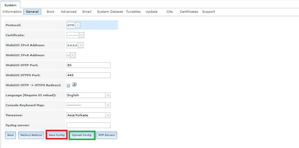

Next time when you setup use this screen for config backups
Refer the pic attached. Red creates a backup. Use Green when you install new OS to carry over all your setting from your previous setup.
There are ways to setup saves in a time bound manner (daily/weekly/hourly). I just have one backup stored in my dropbox/mail so that I have minimal chances of losing the file. I personally have had the usb stick failing on me a couple of times.
