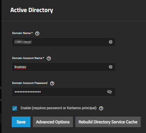

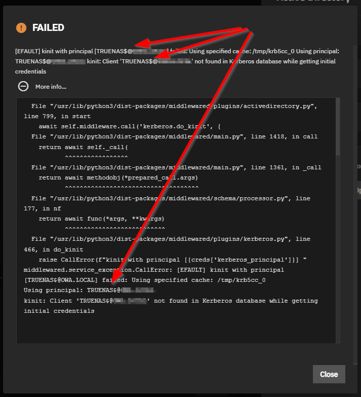

I went ahead and installed the 23.10 beta to see what would happen. Got something different there.
This time I got a message that the credentials couldn't be found in Kerberos database while getting initial credentials. But what struck me as odd, was that it looks to have appended a $ to the username. You can see here I set it with the username of `truenas` but in all the messages it says `TRUENAS$@MYDOMAIN.LOCAL`.
This means you have a kerberos keytab created from a previous domain join that you should remove. The DC does not recognize it and is rejecting it.
It was a completely fresh install. Removed any remnants from DNS and AD, then installed the Beta from a new ISO. Made sure to overwrite the existing install. First thing I did after setting up networking to to try to join the domain and that was the error.
Resolved it by disabling AD, saving, then re-enabling ad with advanced options where I told it to use a new keytab.
