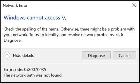

Plz help a newbie. I have a TrueNAS server has been working properly for months. Then I switched it off and on. Since then I can see the TrueNAS dashboard and the Plex plugin is working fine but I cannot access the server in win explorer. I got a network error - see below. Don't know what to do. Restarting win10 and router doesn't help. What might've been changed?

Try by IP address or local host address
IP example:
\\10.10.10.1\share
Local host address:
\\nas.\share
Good luck,
Morris

Thank you. Disconnecting the windows network drive did the trick. I don't know why though.
It was probably mapped to a Netbios name that was not detected. That's why I suggested via IP or local DNS.
