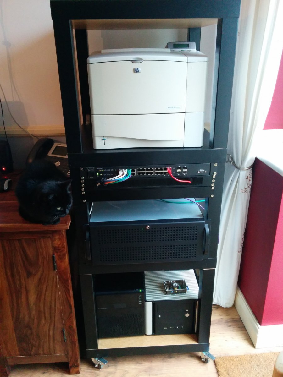

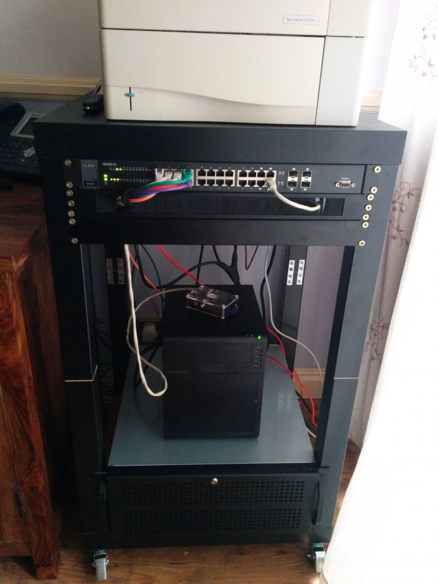

I built a LackRack. The black Lack tables are £5 a piece and the legs are 9u long.
Currently i have one upside-down Lack with heavy duty casters attached (about £8 from Amazon). Another Lack table is right-side up and the two tables are joined together with jointing plates (about £1.50 for 10), but there's no reason not to omit the second set of legs and have a shorter unit.
The legs won't take a lot of strain since they're mostly hollow core, but the tops and bottoms of the legs are filled (chipboard) so you could attach a lightweight pfsense server at the top and rest your FreeNAS server on the base.
The Lacks are 550mm square so you want to make sure your servers are shallow depth.
I've got another 2 Lack tables coming in order to add a shelf in the middle for another server and place one over my printer (to prevent my cat from sleeping in it).

My other 2 Lack tables were delivered today (6 days late) and i've just finished the final TripleStackLackRack build.
It seems to be sturdy enough so far but i might add the 4 spare legs as additional support for the lower 2 levels.
Cost of the materials was £32.50 (although with Ikea's delivery the total ended up £50.50).
Pic of the rack (accompanied by cat wondering what happened to her bed).

Those are pretty cool. Great idea. The fact they are made of compressed cardboard does scare me. It just so happens I have a coffee table version in my basement. It's in my basement because it seems very flimsy. Not the kind of thing I'd trust with my hardware. However, if there was a solid wood (or at least a reinforced version) it would be AMAZING.
Middling
Mar 3, 2012
40
You could get these from Ikea? That'd be nice cause I have a branch nearby.
Sure. The only reason i had them delivered was that it would cost me more to travel to an Ikea branch. If you want rails in your rack Ikea do a towel rail called the Bygel that is an exact fit for their Lack tables. The rails are around £1.50 a piece, but they only sell them instore.
I worried about the strength myself but it seems fine so far. This guy's got a rack built out of the Ikea coffee table you've got and it seems to be holding a lot of weight.
I did consider just using the table as a template and building one out of solid wood legs and thick plywood shelves. The materials cost is near enough the LackRack (about £45 for the wood), but i'm not really confident enough in my handyman skills. If the LackRack proves inadequate i'll probably go this way.
