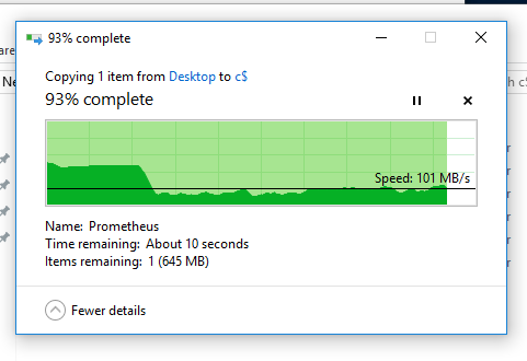

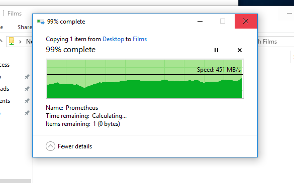

Stux, what kind of benchmarks did you run performance wise, and what kind of results did you achieve?
I'm having some odd issues I cannot seem to find the cause of;
I have FreeNAS running as a VM on ESXi (stored on 960 evo SSD), with my storage passed back through to ESXi using an internal switch for other VM storage (VMXNET 3 NIC to ensure capable of 10Gbps)
I have 4x 2TB drives in a mirror, with an SSD slog and L2ARC (stored as VMDK on my 960 evo SSD).
This has a single zvol on with sync enabled and sparse, and added to ESXi via iSCSI (mtu on freenas interface and ESXI switch set to 9000).
I also then have 4x 3TB drives in a mirror, with no SLOG or L2ARC added, which has one dataset with sync disabled. This then has an SMB share on it for client file storage.
If I copy a large file (7GB) from a test VM which is on the 960 evo (to avoid read speed bottlenecks), over the network (internal ESXi switch all VMXNET3 so 10Gbps) to a VM stored on the iSCSI datastore in FreeNAS, I see about 300MB/s for a little while, then it drops down to below 100MB/s as per attachment. I can definitely see activity on the SSD SLOG, and I know it is capable of far higher than 100MB/s
If I copy the same file from the same VM to the SMB share, I get a constant ~350MB/s
If I do the reverse, and copy from a VM on the iSCSI datastore to the test VM, it tends to stick around 100MB/s
If I copy from the SMB shared to the test VM, I get an almost constant 350MB/s
Any thoughts on where I should be looking for issues, as the disks hosting the iSCSI for VMs are 7200rpm, compared with the 5400rpm of those with just an SMB share on, so I would expect any difference to be the other way around.
Is that the same 960 that you are also using for you SLOG and to host the VMs?

To directly answer the question, I tested the iSCSI/NFS performance and all the various disks using macos/linux and Windows in VMs. Sometimes with direct pass-through.
I also conducted various iPerf tests from various VMs to FreeNAS, and from real hardware over 10gbe switches etc.
As @Chris Moore points out, SLOG performance is greatly affected by the SLOG. I performed a number of benchmarks in this thread https://forums.freenas.org/index.php?threads/testing-the-benefits-of-slog-using-a-ram-disk.56561
And you can use the same methodology.
A 960 Evo makes a terrible SLOG btw.
So, can you provide some more detail on what hardware you actually have, and how its set up
I think you're using a VMDK as your SLOG, and the VMDK is on your Evo. I never did determine if the sync writes are getting through to ESXi. I assume they're not really, otherwise I'd expect performance to be pretty bad.
My initial SLOG via VMDK tests were performed with a Samsung 960 Evo holding a VMDK, which might make a difference, but notice I upgraded to an intel P3700 after doing my ram disk tests.
Also, be aware that L2ARC can cause performance issues if you don't have enough L1ARC (aka ARC) as result of not having sufficient extra RAM to support the L2ARC data.
My system seems to only be able to write a total of about 1GB/s or so, and that then results in circa 450MB/s when using a SLOG with sync=always as everything gets written twice.
Have a good look through the RAM disk test thread.

Disabled sync on the zvol hosting the iSCSI datastore, removed the SLOG from the pool, and removed the L2ARC;
It still does the same thing of starting the transfer high, then ultmiately dropping down to sub 100MB/s speeds :mad:

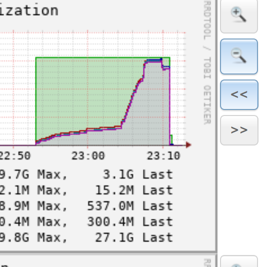

EDIT: Is it memory usage?
The attached is memory usage after running a couple of test copies of this 7GB file

Run a local benchmark writing to the pool that hosts the zvol. Ie dd etc from FreeNAS terminal
My suspicion is the pool can only sustain 100MB/s for some reason. The initial fast performance is the initial writes hitting ram buffers etc, but eventually the data has to hit the disk.
