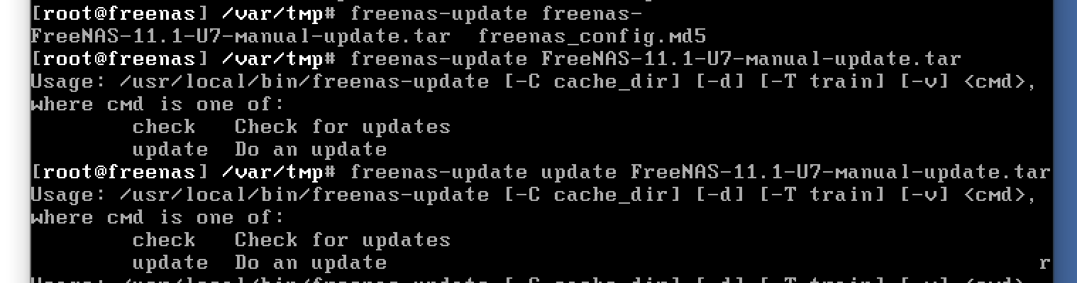

Have you tried copying the FreeNAS-11.1-U7-manual-update.tar file to /var/tmp/ and then run "freenas-update FreeNAS-11.1-U7.tar" and after it finishes reboot?
Seems that syntax doesn't work, this was my problem before I think...
I tried:
freenas-update update FreeNAS-11.1-U7.tar
freenas-update FreeNAS-11.1-U7.tar update
No go...

That's a shame. Works fine in vers11 so must be a 9.3 thing.
I guess you've tried "freenas-update -v update" although given your proxy server issue I doubt this will work.
