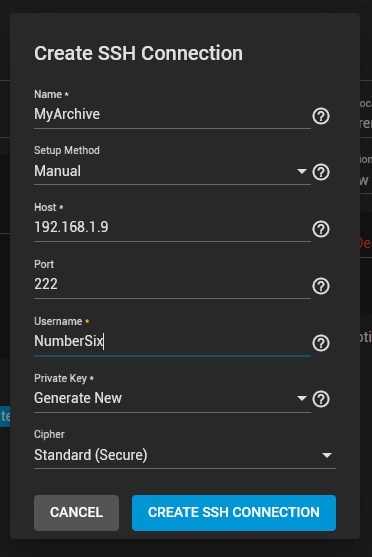

So now I'm wondering if an alternative approach might be Replication via the GUI?
I wonder if I can use Replication as a way of saving snapshots to Windows 10? I explored the GUI 'Replication' area and of course it wants a source and a destination on different systems. I assume that since NAS and System are two pools on the same PC, these do not count as different systems, but clearly the Windows 10 machine (through which I administer the headless TrueNAS box, incidentally) is. However my attempt to specify the Windows machine and make a ssh connection (I have no experience of ssh) fail, with messages ranging from immediate no such destination to only slightly longer timeout messages. Am I wrong to think I can store the 'metadata' that is a snapshot on Windows until needed, or am I simply not addressing the Windows machine correctly - see attached screen grab? Related - if this connection is possible, is there a way to specify a destination folder on the target machine, or would that dialogue appear later in the process?
I have read that you can only use Replication if the target machine is running ZFS, but that snippet refered to a much earlier version of Freenas from a few years ago, and I'm wondering if perhaps I can at least send (but not activate) the snapshot data simply to be passively stored under Windows.
N.B. I changed the port number to 222 in testing since the default '22' proved impossible to open explicitly in the network hub.

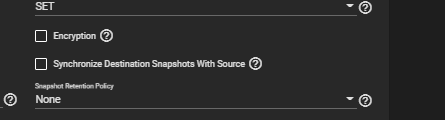

EDIT: Scary last minute re-reading of what 'Replication' actually does; will this blow away the filing system on the target pool by using the snapshot involved to over-write what's at the destination, or is it just going to do what 'zfs send' does and store the snapshot in a new location, only via a GUI and to a schedule??!

You need to have the Synchronize box checked to allow "replication from scratch" and you need snapshots on the source.
Hi Redcoat - thank you (again!) for that. However I just posted elsewhere in this thread:
and I'm increasngly thinking that may be the correct interpretation of what it does. In which case - phew! I just saved myself from destroying some six week's work in setting the NAS up to this point by overlooking a couple of check boxes! That was close!!!
Redcoat
Feb 18, 2014
2,922
I don't understand what you you meant there. Replication takes the snapshots from the source and puts them into a destination location you specify. If that location doesn't have any snapshots in it, replication from scratch needs to be enabled with the Synchronize box check (if it isn't the replication fails as you found out).
