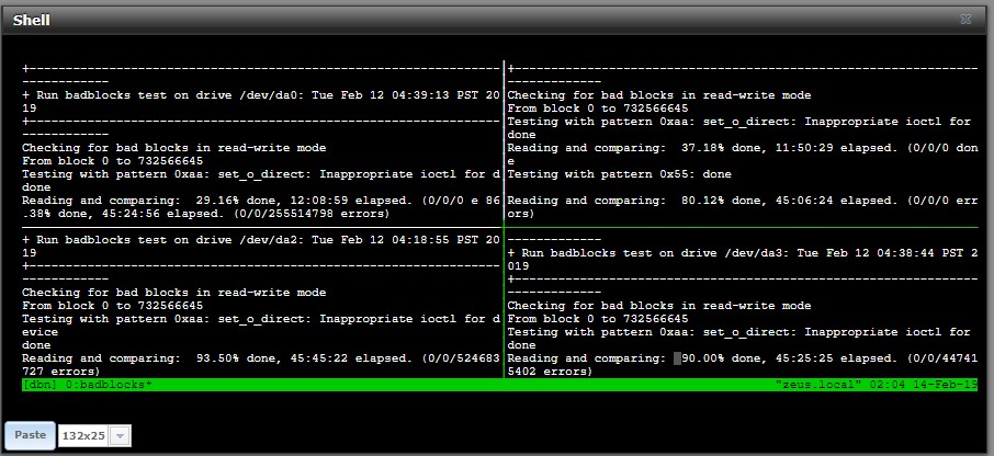

I've been running disk-burning tests on my new HDDs using https://forums.freenas.org/index.ph...for-freenas-scripts-including-disk-burnin.28/
Of 4 HDDs, 3 of them are showing a lot of read errors.
Are they really all damaged? 1 of them is a WD blue (meant for backups, not to run inside the NAS, just plug-in and plug-out), the other 2 are WD Red and I'm surprised they all come with damages (they have been bought various years apart from each other)
I must point out that I updated the script to use the -c 262143 flag: badblocks -b 4096 -c 262143 -wsv -o "$BB_File" /dev/"$Drive"
Which should speed up the process (it's been running for 3 days straight and it's still far from being completed. URGH).
Do I have to change all those disks? Could it be a software problem related to the readings and the -c flag?

Not sure but this is what I do.
sysctl kern.geom.debugflags=0x10
badblocks -b 4096 -ws /dev/da0
The only time I've had errors similar to this on lots of drives is when I ran badblocks on an already configured pool. The pool had no data on it and was still in the build process but it didn't like it. Therefore now I always run badblocks before I configure the pool.

@Johnny Fartpants I did run the same sysctl command (and didn't reboot), and don't have a pool configured. My only difference is that -c flag
Sigh, either I need to rerun the tests or my hdds are broken. Amazing...
I worry that the change to the script may be the root cause here.
I looked back over your posts and I may have missed it because I was scanning visually, but what kind of drives are we talking about?

No sorry, I forgot to mention the specs:
3 WD Red 3TB and 1 WD Blue 3 TB (it's not meant to run in FreeNAS, I'm just using it to test the drive before usage)
Regarding the badblocks program: the -b and -c options work together; -b lets you specify the block size, and -c lets you specify the number of blocks to test at a time. The default for the latter is 64; I often use 128 or 512.
I reviewed the source code for badblocks some time ago, and -- if memory serves -- it allocates a buffer which is basically sized by multiplying the number of blocks (-b option) times the number of blocks tested at a time (-c) option. So you want to keep this number small enough that the resulting buffer will fit in the RAM available to the badblocks program. Otherwise it will end up swapping to disk, which wreaks havoc on performance. In any case, I honestly never saw any noticeable gain in performance from using larger values for the '-c' option.
The upshot is that I recommend you use a much smaller number for the badblocks '-c' option, say in the range of 128-1024.
Having said all that... I really don't know if your badblocks invocation caused the drive errors you're seeing, so I wouldn't give up on the disks just yet. I'd look at the results you get from the short and long smartctl tests, and if those look okay, perhaps run the badblocks test again with a much smaller '-c' value, just to rule out the possibility that it was indeed the large '-c' value that caused the errors.
I don't want to give you any false hopes, but it never hurts to double-check.
Good luck!

The other HDDs are still running badblocks. Sigh.
The sad part is that one of the 4 drives ended up perfectly healthy after all those tests, even the extended smart shows all good, so it's a clear indication that I got 3 faulty drives...
I'll find some usage for those (obviously I'll run all the tests we discussed about).
What I'm not convinced though is that the -c flag can impact something. The only reason it could is if the RAM has a problem, but then the other HDD would have the same problem
also, -b 4096 -c 262143 is 1GB of RAM (I have 32), which should be totally fine. Now I don't know how badblocks manages the whole thing, but the docs didn't point out at any such problem.
SIGH again. I really wish I'm wrong.

+ Finished burn-in of /dev/da1 : Fri Feb 15 15:56:33 PST 2019

Attached, the four smart tests. da0 is the healthy disk and da3 the wd blue
  • da0.txt
  • da1.txt
  • da2.txt
  • da3.txt
Maybe I am overlooking something but I don't see anything in the SMART results that would stop me from using those drives.
I can't explain the errors you were seeing, but the SMART test results look passing.
Fire-Dragon-DoL
Dec 22, 2018
103
well, badblocks wrote 1.5GB of bad-blocks (list) for 3 hdds, but all of them have healthy smart tests...
Chris Moore
May 2, 2015
10,079
That makes no sense to me. How do the SMART results show no faults if there actually are bad blocks. I think there must have been some sort of memory fault between the data written and the data that was read back, like @Spearfoot was suggesting, the data in RAM didn't match the data read back from the disk, so badblocks thought it was a fault, but the fault was software, not mechanical. Strange results.
If you ran the script again, setting the values back the way they originally were, it might pass with no errors.
Fire-Dragon-DoL
Dec 22, 2018
103
That's my thought, but I must point out that one of the drives didn't get any error with the same parameters.
I wonder if the issue might be related to hyperthreading? Who knows.
With those smart tests, I can't even send those HDDs back.
