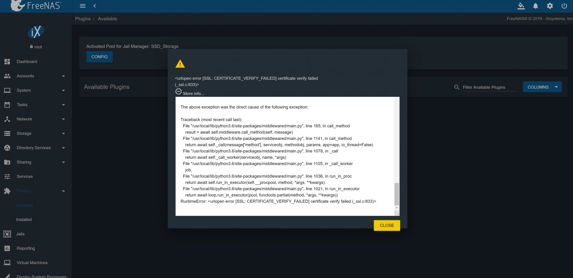

I just installed 11.2-U3 (from 11.1). I figured I'd install the Plex plugin and start playing around with the new (new to me, anyway) UI. I went to available Plugins and get this error. Any ideas?

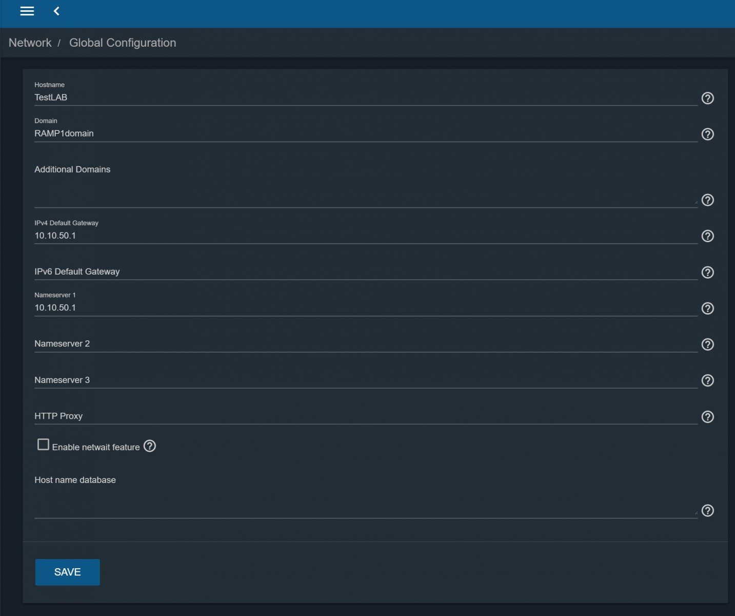

Have you configured DNS servers and default gateway under Network -> Global Configuration?
Turgin
Feb 20, 2016
43
Assuming those are valid addresses for your network that's probably not your problem then. I had neglected to set nameservers on a new install and had problems similar to yours so I thought I'd mention it.

Well, I decided to go ahead and do a fresh install of FreeNAS 11.2 and I'm getting the same error.

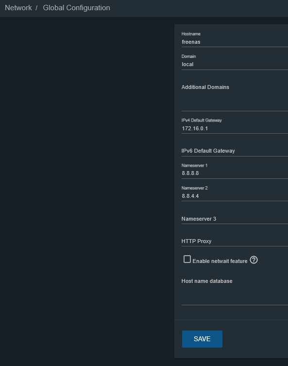

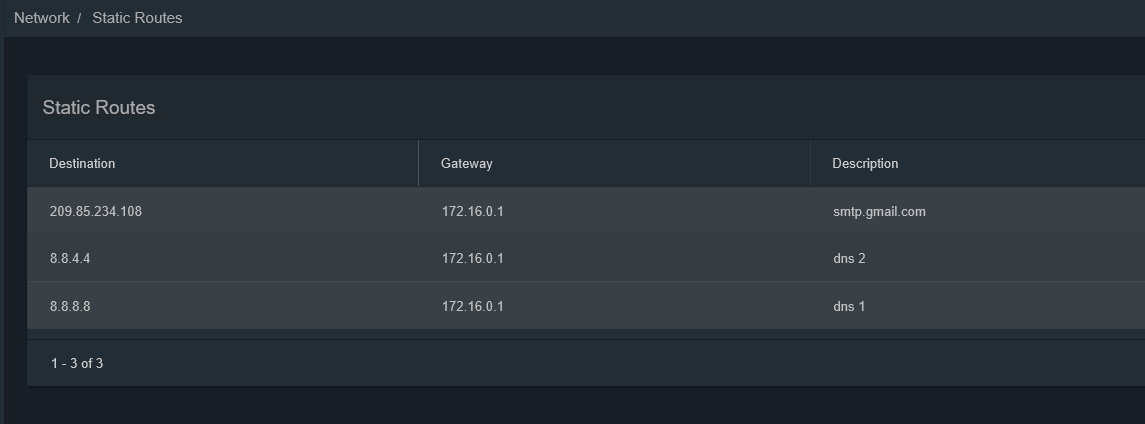

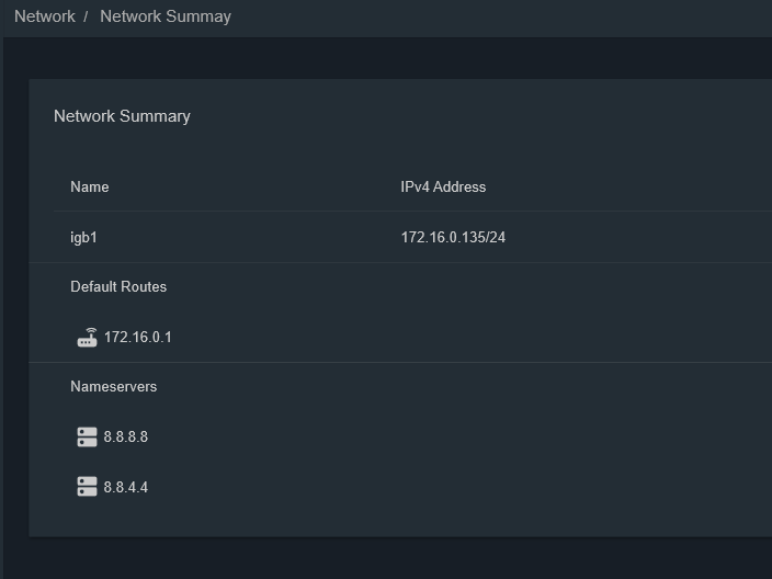

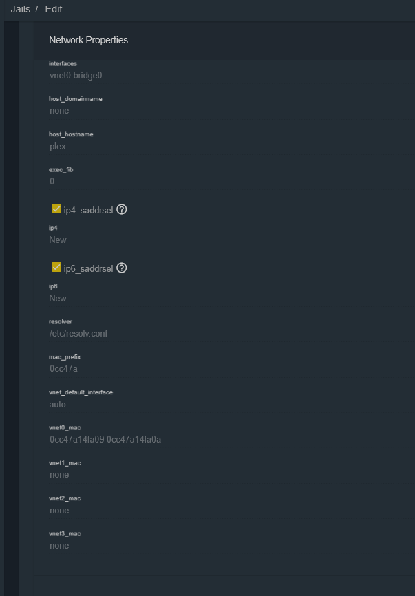

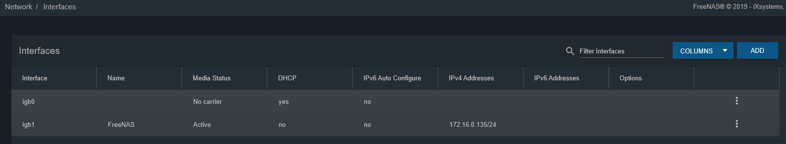

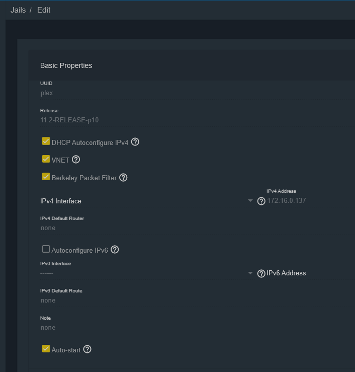

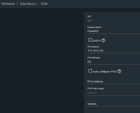

I seemed to get this working. At first, I thought I had a firewall issue. But no.
I rebooted a few times, tried DHCP, then went back to more static addressing.
I think it was related to the system (FreeNAS or Jail - don't know which) not finding the DNS (hostname server).
I did create static routes to automatically find 8.8.8.8, 8.8.4.4. this might have been the trick.
I will post my config if others request it.

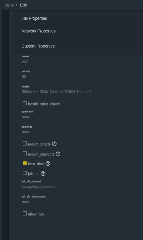

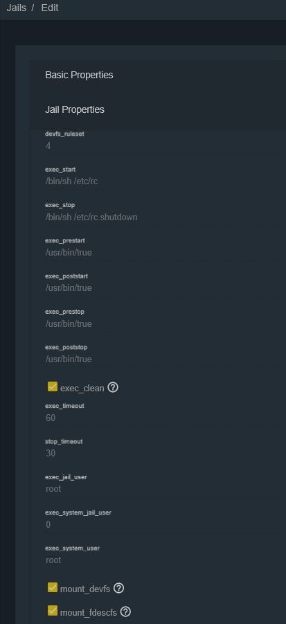

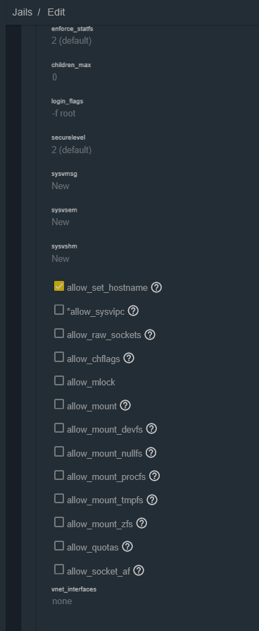

adding the rest of the screen shots....
