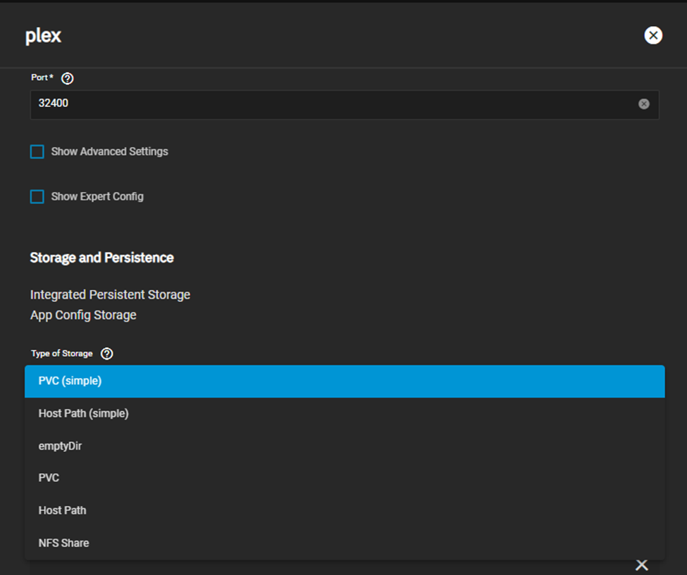

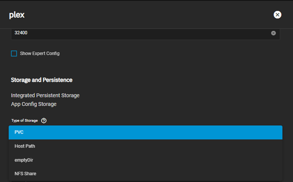

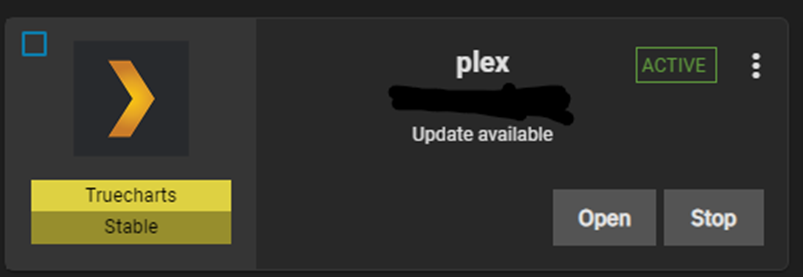

After upgrading to RC1 I have been unable to upgrade ANY of my apps without re-installing. Is anyone else noticing this issue? Issue looks related to a change in the existing Storage Type being unavailable:
Current Configuration:

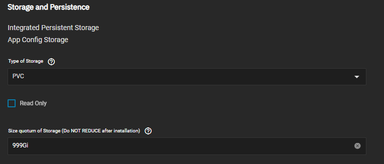

Clean Install options: (Notice the first two options are gone)

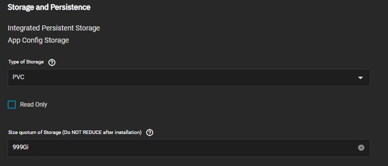

Change service Type from PVC(Simple) and hostpath(simple) to just PVC and Hostpath.
Change the PVC Size to 999Gi. That should fix it.

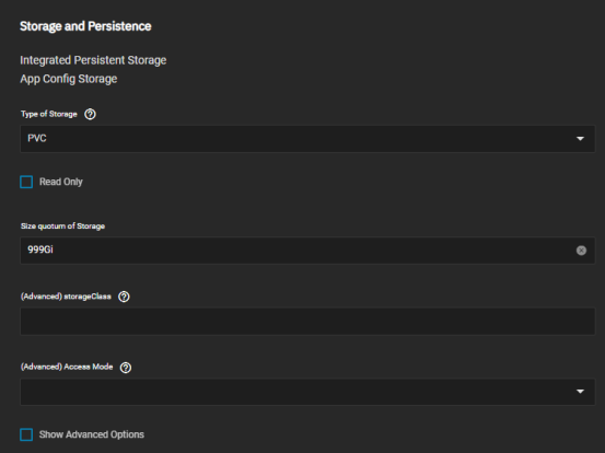

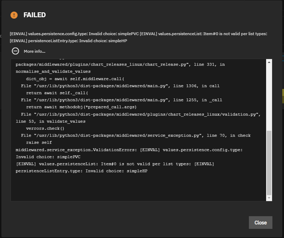

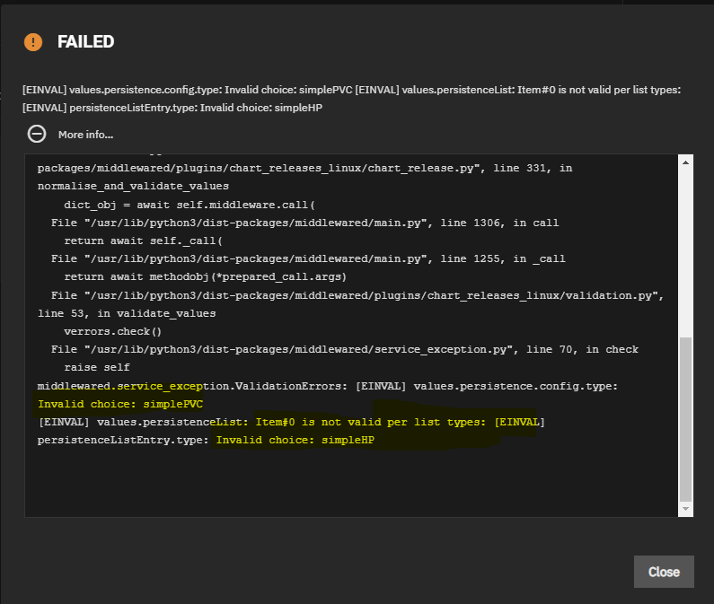

I tried changing the options but I get this error when trying to save
Error: [EINVAL] values.persistence.config.accessMode: Invalid choice:
After changing to PVC from PVC (Simple) there are two additional (Advanced) fields that need to be filled:
(Advanced) storageClass
SCALE-ZFS
(Advanced) Access Mode
ReadWriteOnce
