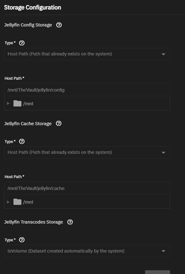

Some official apps not allowing to change location after I set it up at installation.
Location settings and path are grayedout. Is there a way to change it?

Going to put my hat in this too so I can keep updated on the issue. Both apps I use exhibit exactly what the OP image shows
Unable to choose between a) path under ix-application and b) hostpath. under Config Storage/Additional Storage
Under Advanced Settings for Apps the Enable host path safety checks is unchecked and all had been working just fine.
I noticed this after the Bluefin update to TrueNAS-SCALE-22.12.4.2.
Also I have a TN Scale VM set in Virtualbox that was upgraded to Cobia and it exhibits the same issue with apps that were setup after the upgrade. I do not know if the issue existed before the upgrade, but probably did as the VM was up to date on Bluefin before upgrading to Cobia.
Both apps have a host path setup when they were initially configured. Filebrowser browses a couple SMB shares.
