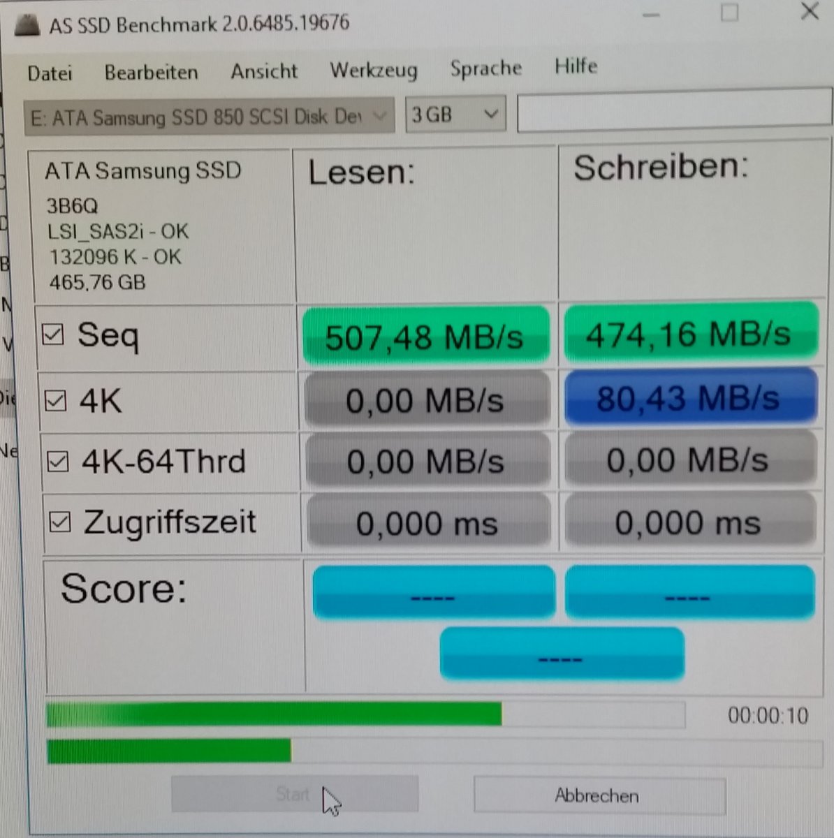

Edit: I have made a speedtest with AS SSD benchmark (attached). Seems to be a little bit to slow, as 500/550MB/s should be reached. Also Samsunbg Magican cannot reconize the drive, as it is attached per SCSI. But this is ok i think.
Edit 2:
Connected via SATA. Same speed results so all is fine. Latest firmware for SSD checked -> fine.
Now back 2 the initial question :)

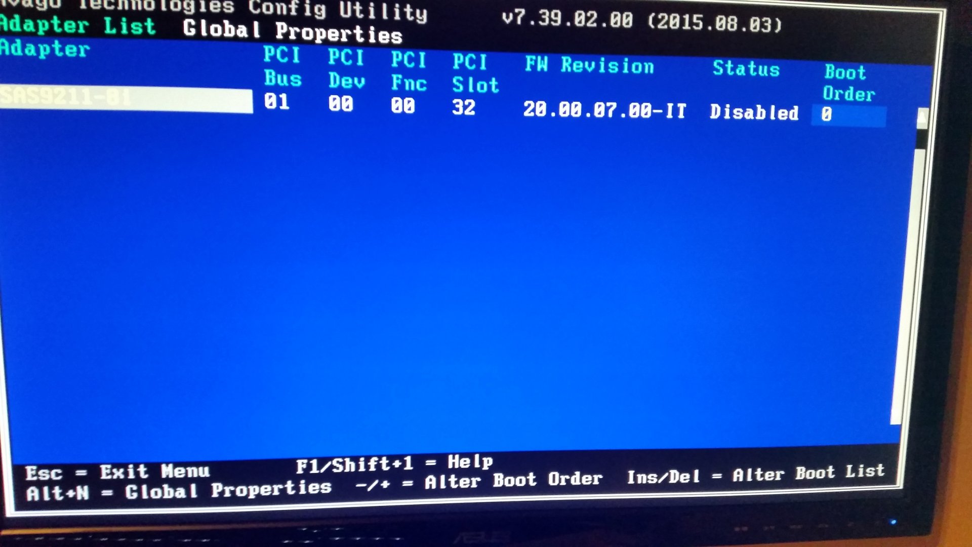

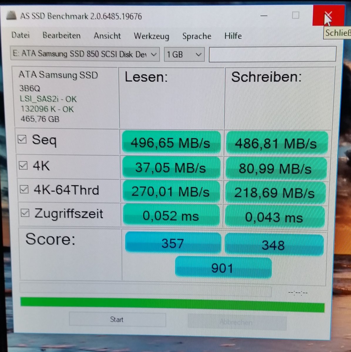

Ok I have now updates successfully on 20.00.07.00.
Thnak you all for your help.
I needed to make a bootable UEFI version with rufus to do this.
Maybe someone need help, follow this link: https://wiki.hackspherelabs.com/index.php?title=LSI_Raid_Firmware_Bios_Flashing
and
https://techmattr.wordpress.com/201...-flashing-to-it-mode-dell-perc-h200-and-h310/
I have also disabled BIOS & OS boot completely, because no disk will boot from the controller. So the controller has the "disabled" state I suggest.
Speed looks nearly the same.
cheers
Ice
