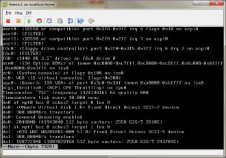

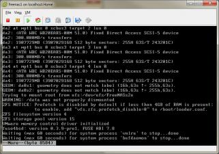

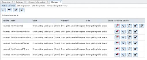

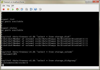

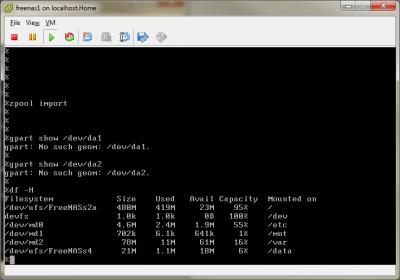

I've got a Freenas 8 virtual machine running on ESX server. Freenas boots from USB, has got access to SSD drive where I store all VMs and there are four 2TB HDDs for data. Those 4 HDDs are in raid z.
There was a power cut and after that I cannot see any files anymore. To be honest I've got no clue how to fix this (if it can be fixed at all) and I'm hoping someone here will be able to help.
I've attached the screenshots of output of various commands to help to diagnose the problem and find some solution.

I'm confused. You have a ESX server with 4 disks containing your VM files (and ESXi files I suppose).
You created a VM for freenas, but instead of creating a virtual drive for OS you installed it into a physical USB flash?

I guess it was no such a good idea to virtualize freenas...
It cannot find any metadata in the disks about ZFS.. not sure where to go from here... perhaps the file your export on how you export the disks from vmware got corrupted...
