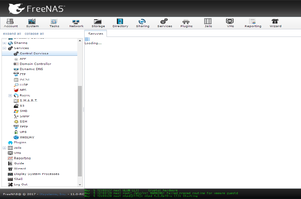

Hi Guys,
After updatting to FreeNAS 11.0 Stable from FreeNAS 9.10 Stable,
I can't open the service menu [Control Services]...
Thanks any advice.

Error message? Did you file a bug?

Clean cookies, try different browser, try private mode? Maybe bad boot media?

Hi SweetAndLow,
the log message just following:
May 5 12:03:27 nas1 GEOM_ELI: Device ada2p1.eli created.
May 5 12:03:27 nas1 GEOM_ELI: Encryption: AES-XTS 128
May 5 12:03:27 nas1 GEOM_ELI:	 Crypto: hardware
May 5 12:03:27 nas1 GEOM_ELI: Device ada3p1.eli created.
May 5 12:03:27 nas1 GEOM_ELI: Device ada4p1.eli created.
May 5 12:03:27 nas1 GEOM_ELI: Device ada5p1.eli created.
May 5 12:03:27 nas1 GEOM_ELI: Device ada6p1.eli created.
May 5 12:03:29 nas1 root: /etc/rc: WARNING: failed precmd routine for vmware_guestd
May 5 12:03:29 nas1 ntpd[2178]: ntpd 4.2.8p10-a (1): Starting
I deleted all cache, cookies of chrome, IE, firefox,
but it doesn't make change this issue.

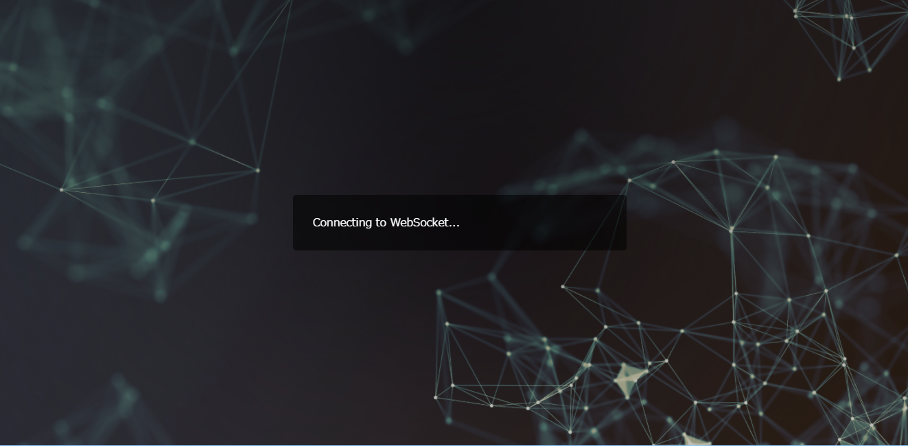

Today, as announcement of FreeNAS11.0 Release,
i upgrade my FreeNAS11.0 RC3 to FreeNAS11.0 Release.
After testing for new release, I known that when i access FN11.0 Release
from terminal place at other segment local network,
ex:
FreeNAS11.0 Release (192.168.1.x/24)
Access Terminal (192.168.2.x/24)
1) with legacy UI, can not open the service menu "Control Services"
2) can not open the login screen with new UI (as attachement image)
I think that above these two access were using the port that was different with 80, weren't they ?
luciusf
Jun 17, 2017
I'm experiencing the same problem.
If accessed via Win10 (Firefox, Chrome, Edge) the services menu in the standard UI on FN11.0 stable doesn't open.
Also the new UI won't open as well (like the comment before noted).
However, if accessed via Safari both works.
An old openbsd machine with firefox could not open the services menu, but access the new ui.
Being a new FreeNAS user I'm not familiar with where to look for the correct logs, /var/log/ doesn't reveal anything useful to me.
Thankful for any hint.

Its a known issue, a lot of people had that issue and still have it. Will probably be fixed in the next update. It works probably 10 percent of the time, been that way since the RC days.
I find this weird, because it's worked fine for me on Edge and Firefox.

Firefox 54.0 (32-bit) and IE 11.0.9600.18665, Win7 x64 Pro SP1 Does not work normally.
Log:

green
Feb 15, 2016
the same problem
found this report https://bugs.pcbsd.org/issues/23941
they were resolved the issue by the assigning the static IP (?!)
for me it is not working ((
updated: i'm using ff 52.2.1 esr
was trying use chrome and no luck to
system is windows 7 x64
after all i tried to use chrome on android and it worked!!! o_O
Mihalich
Mar 14, 2017
297
My FreeNAS has a static IP, it also does not work.
