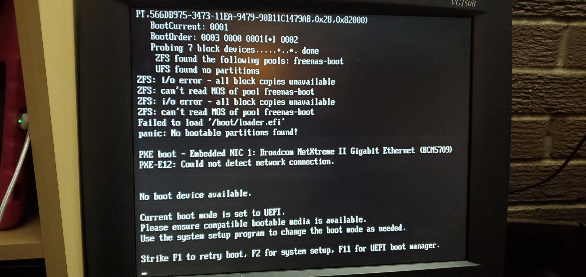

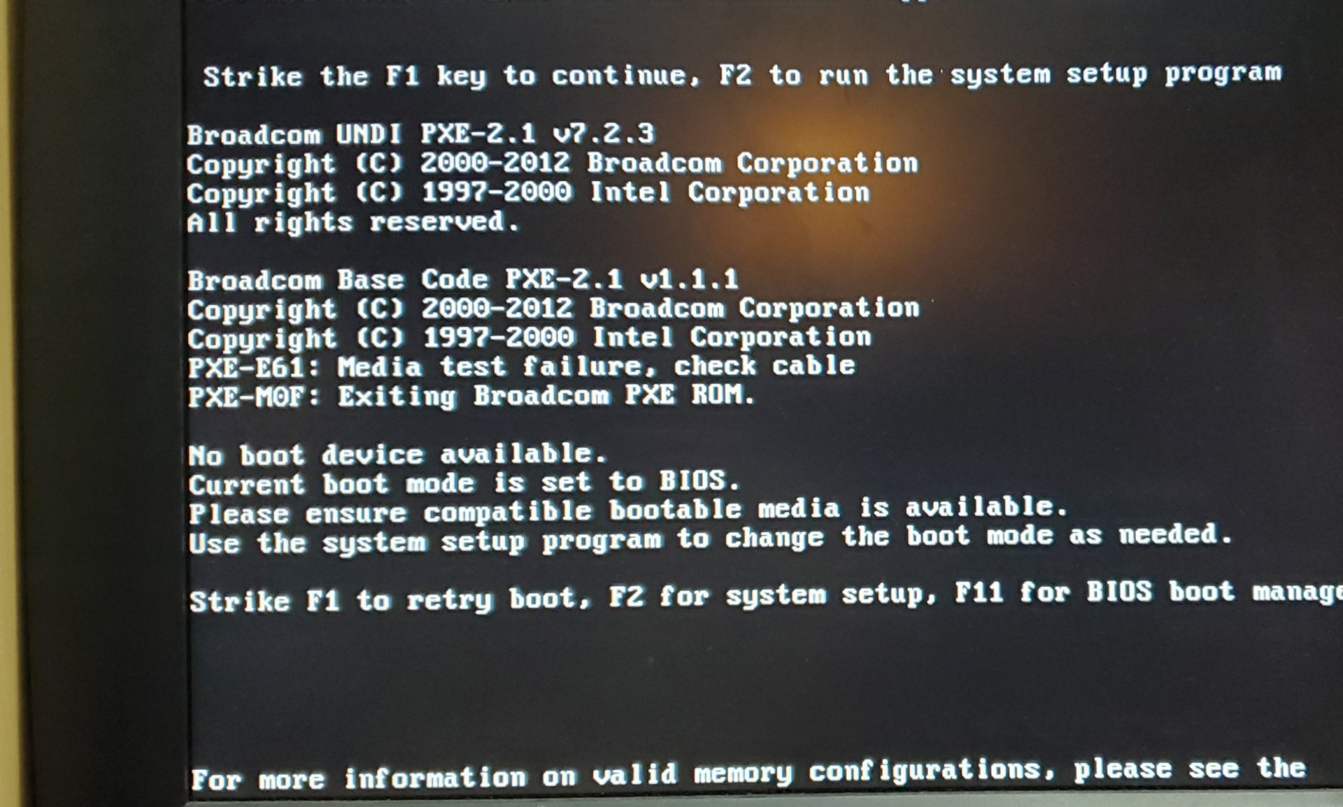

Hello, maybe you can help me.
I have a Dell R910 with 4 xeons 2.26 and 184gb of RAM. I am using 2 64GB of RAM and was using the last FreeNAS version 12U7.
For some reason my system froze and the only option I had was to prees the power button untill it went off and then power back up, But after this the system wouln't boot any more, it tells me that ZFS found the pool "freenas-boot" but then it says "can't read MOS of poool-boot" and the "failed to load '/boot/loader.efi' and then it tells me "No boot device available"
so I don't know what to do cuz I try to install the system on another USB but at the end I couldn't import my pools.
can you halp me?
I want to clerify that my the system was setup to boot on UEFI, so I try to boot on BIOS and obviously it wont boot.
