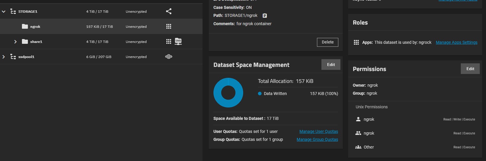

I'm just trying to get the docker image to deploy so that I can go and configure it.
I have setup a dataset called ngrok, I have a user and group assigned in the credentials to ngrok (user 3001, group 3002).

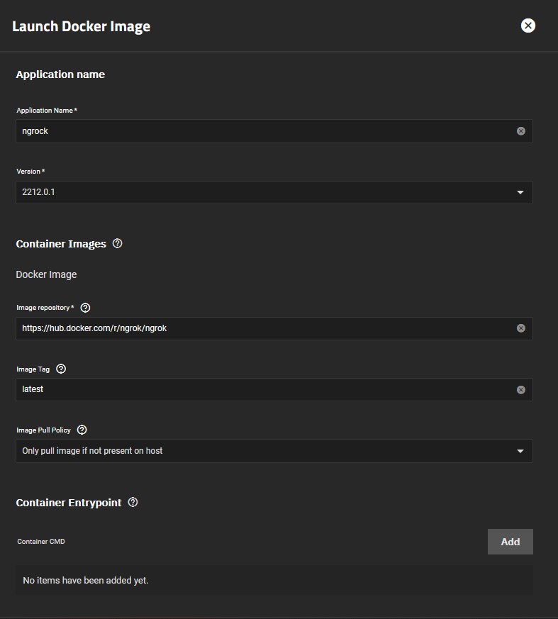

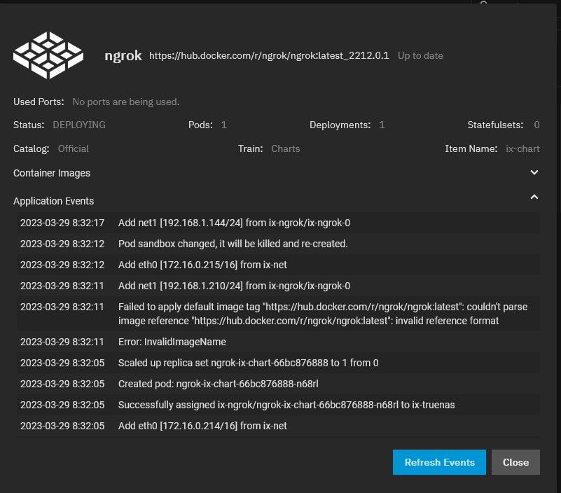

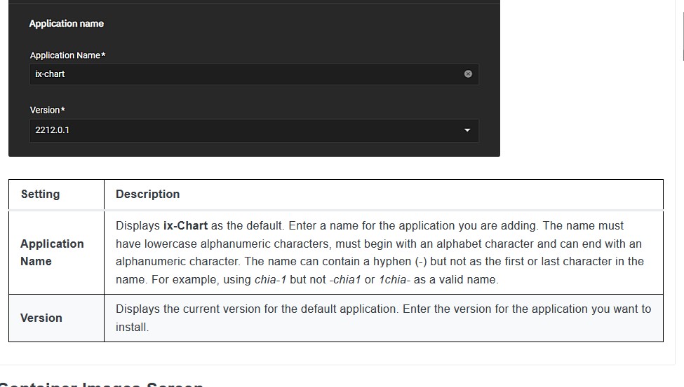

I have tried several variations on how to setup things in the Launch Docker Image menus. It never goes past Deploying. One issue I might see is that TrueNas Scale doesn't seem to let you change the "Version Number" at the very beginning when you start to setup in the Launch Docker Image. The Docs Hub guide says to enter the version of the application you want (For ngrok it would be 3.1.1?), but it seems stuck on 2212.0.1 which is the default. I think that is screwing up the image pull.

So the image repository just needs to be ngrok/ngrok (the rest is assumed/automatically filled).

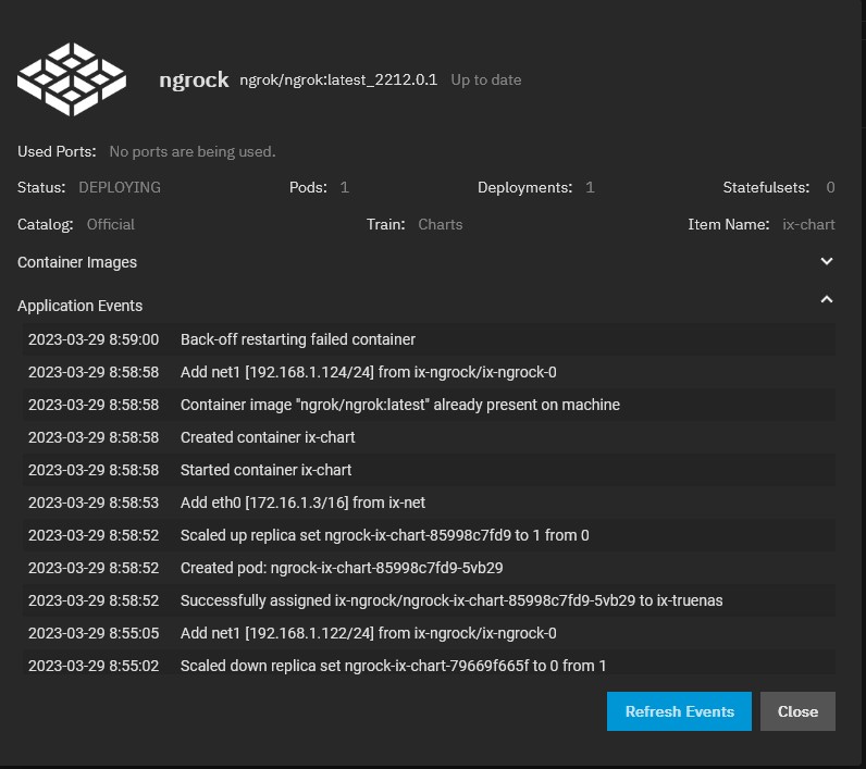

That seemed to help, but it is still not deploying.

Other than the name of the image to pull/run, what have you specified in the app settings? it's probably something there that's preventing it from starting.
The examples seem to be suggesting the container cmd needs to be something like http 80
I guess without a command, the container just exits.

I have the Networking Host Interface set to bond1, DHCP
Storage Host Path to /mnt/STORAGE1/ngrok
Mount Path to /mnt/STORAGE1/ngrock/data
Then Configure Container User 3001 (which has credentials to the dataset /ngrok) and group 3002 (also has /ngrok credentials).
Everything else is default.
See the dataset permissions below.

You need to set the cmd arg to the needed protocol and port like http 80
What are you even wanting the storage to do for you with that app? are you storing the config file there?
