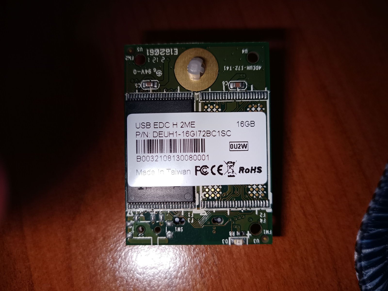

Thanks for the reply. I haven't disassembled the casing yet. If I disassemble it, it's to see exactly what USBDOM it has, but first I want to be clear about everything, so that what you mentioned doesn't happen to me. Don't remember the specs you bought?
P/N: DEUH1-16G172BC1SC From Innodisk
Wow my house filing system actually worked!!
innodisk and it doesn't work??? She was looking at the new model 2ME2 and she thought it would work.
I think I'm going to disassemble the chassis to gather the maximum of the specifications on the board. Could it be the mA?
no, I got confused, the model I was looking at is the SLC, yours is MLC
