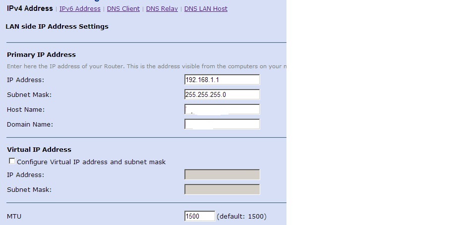

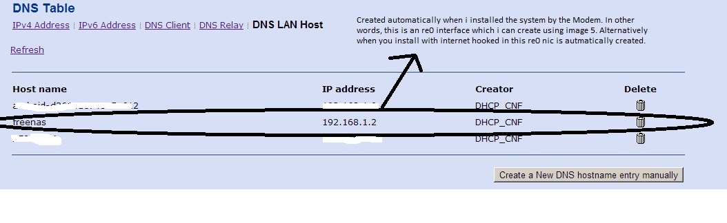

Installation:- While installing the freenas and starting for the first time, i had the NAS box connected to my ISP modem/Router. This automatically create a DNS LAN host entry in the modem with ip automatically populated.
re0 NIC is not set up manually nor i have created any interface connection. This is automatically created as i ran the freenas 9.1.1 for the first time. New install by the way.

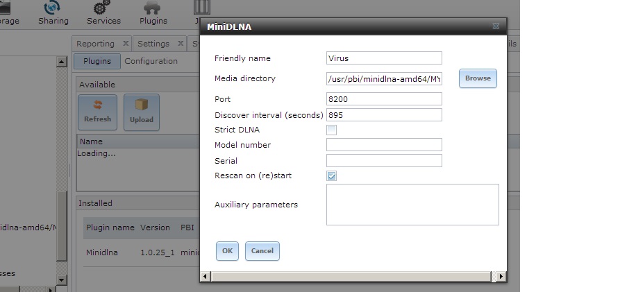

Post installation, i went into the jail in shell and created a folder called media under usr/pbi/minidlna-amd64/MMedia
jail for the MiniDLNA is running successfully and storage is done as follows.
Source - /mnt/Server**/Mediafile(with folders as well)
Destination - usr/pbi/minidlna-amd64/MMedia(inside Jail)

The Nas box is connected to my router/modem directly via ethernet cables. And my systems are able to access the server folder shared via cifs.

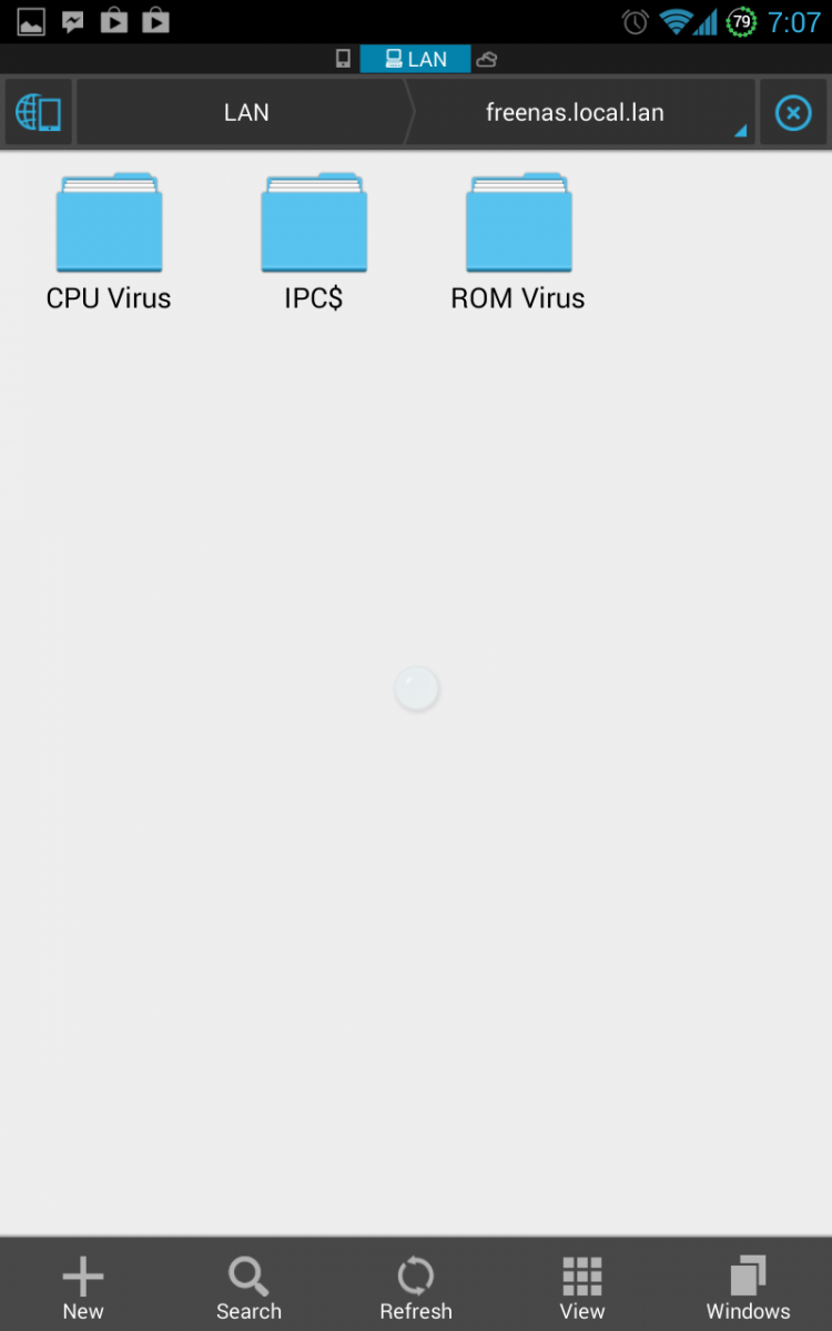

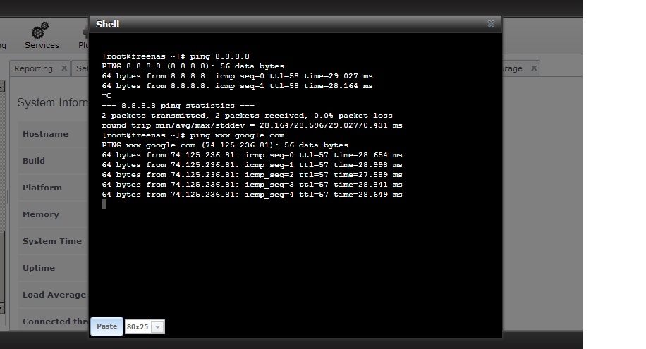

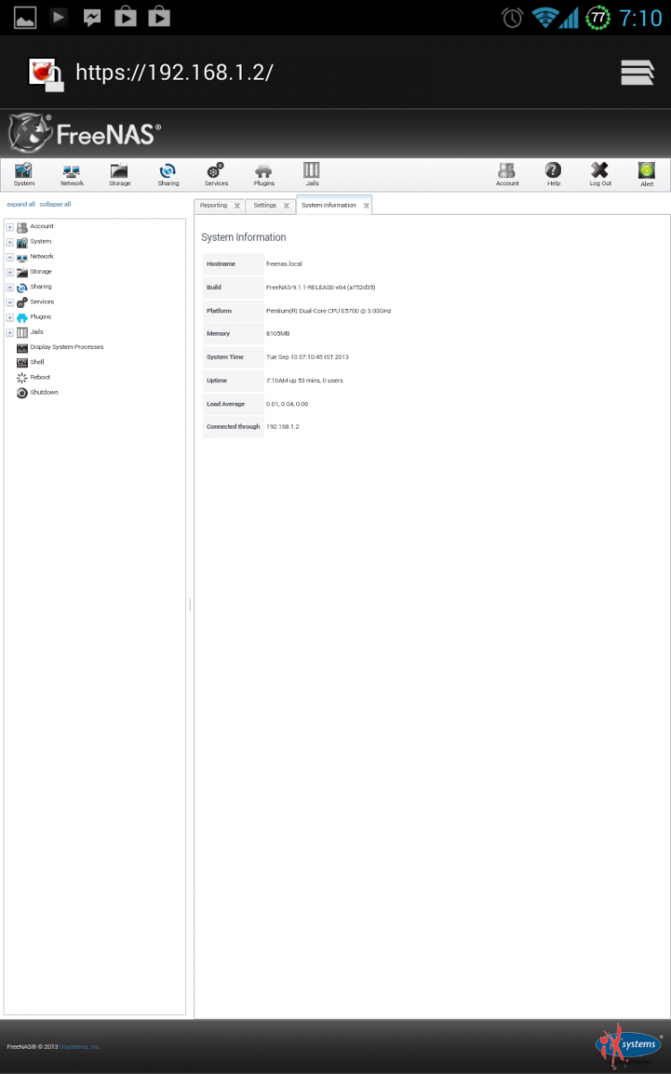

From any PC connected in the WIFI i am able to access the CIFS folders, the web GUI and the jail can also access internet. I am able to see the list of PBI files for installation and verified internet access inside shell.

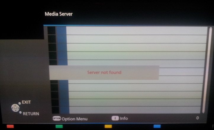

1) The server is never loading into any DLNA client connect to the same wifi the server is connected**(While able to access folders).
Attaching few set up pictures for help.
Issue 2)
The server is loading in DLNA clients if i connect the NAS directly via ethernet to the device. Like a tv. Or like to an access point or switch.

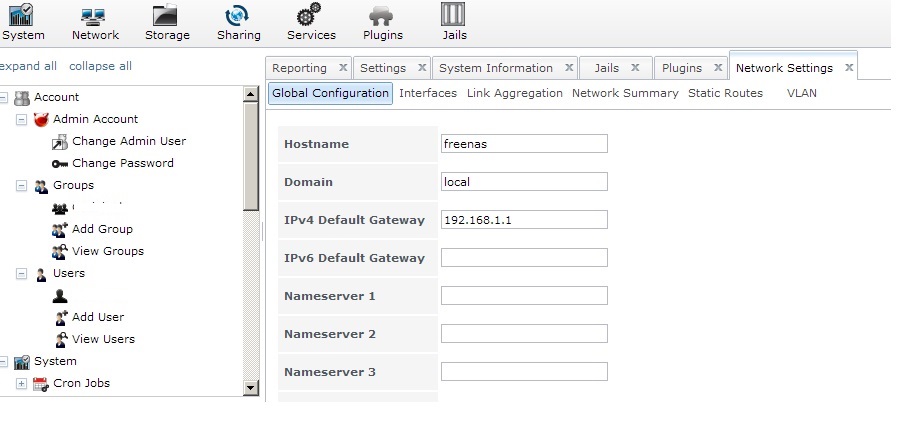

When you create a static IP you also need to make sure it has a default gateway and proper DNS servers configured. Your router IP should work for both of those things.

IPV4 Default Gateway and Nameserver 1 are correct and the same on the Global Configuration tab of the network settings?

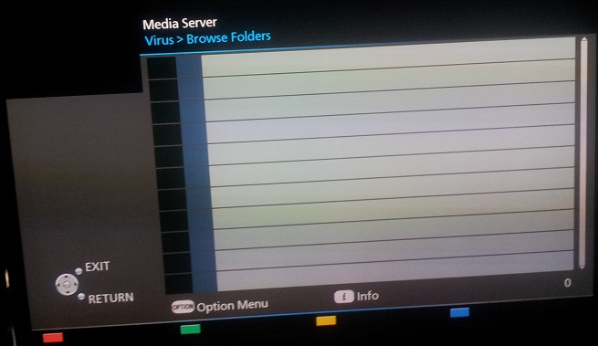

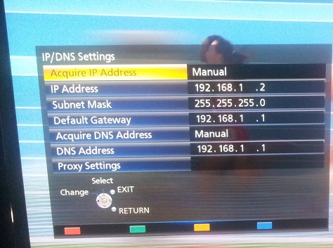

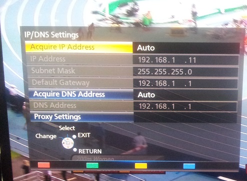

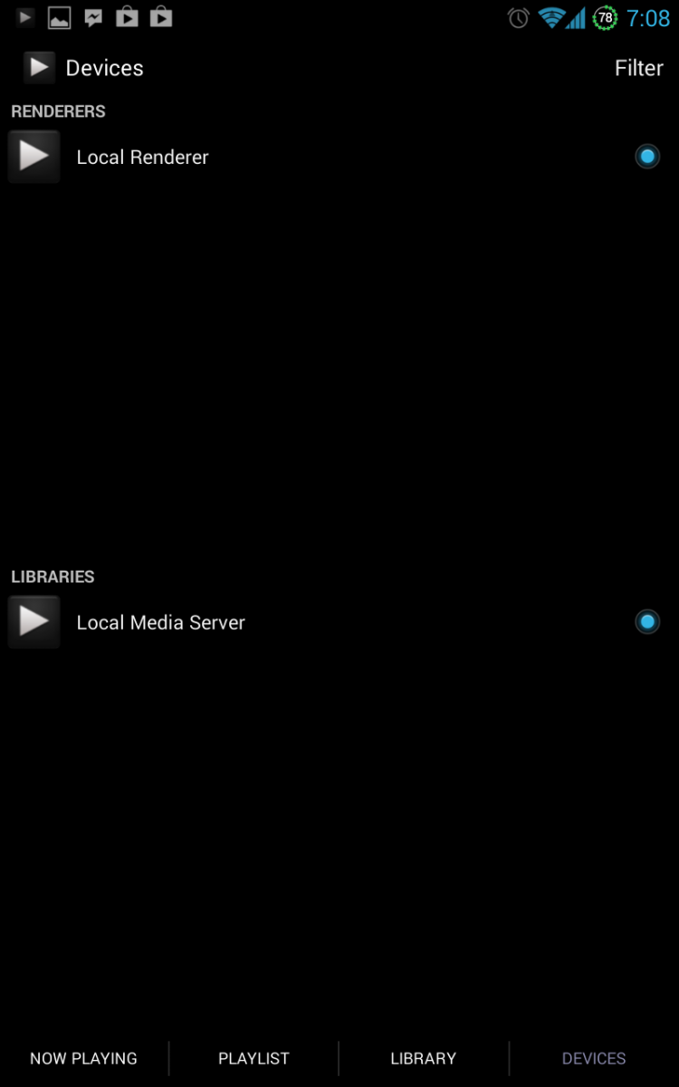

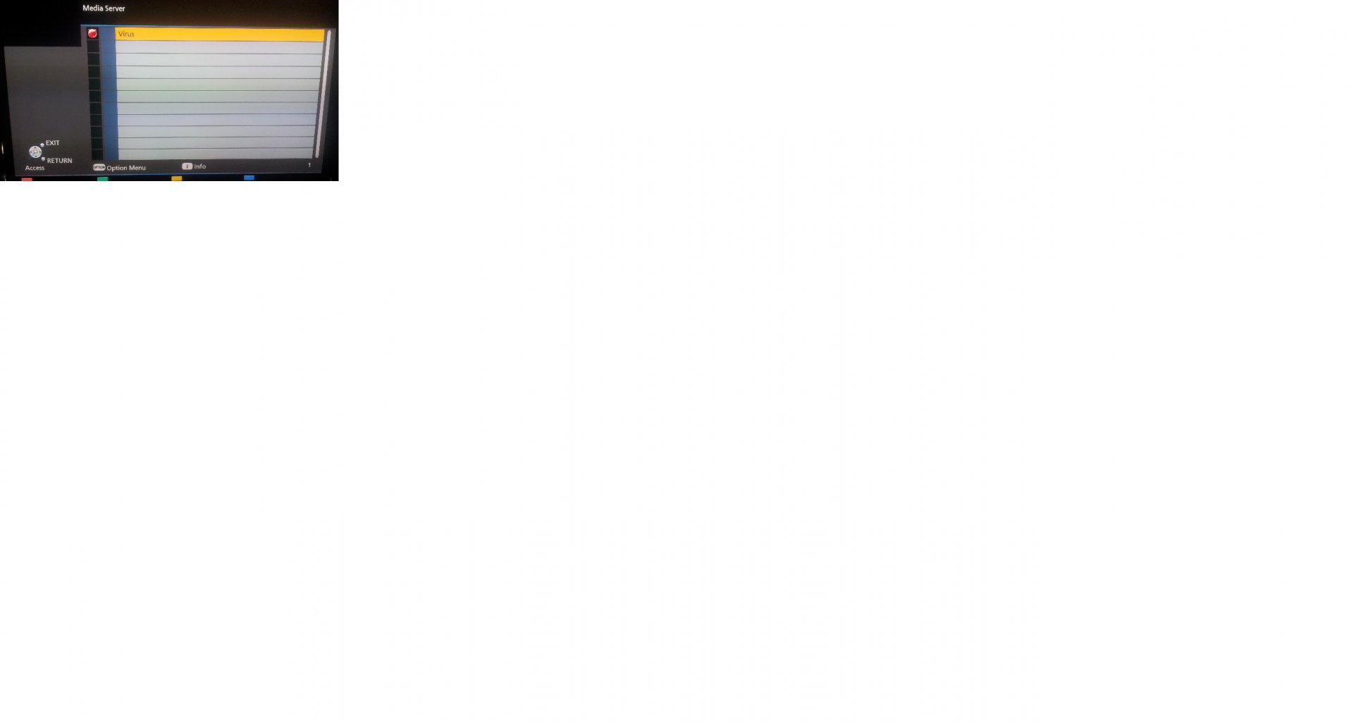

When directly connecting the freenas with my DLNA client(my TV) the server is displayed but no files or folders are displayed. I have mapped my media files and i can see the files inside the jail in the folder i created and i mapped in jail set up. That folder has one mp3 file and this folder is not loading (though server loads)
Here are some more pictures with my TV and Mobile which shows that server connects directly. In Wifi TV does not have server connection. The phone is able to access the folders, GUI but not the server.

Try creating folders for music, movies, photos etc inside the /media folder (in the jail) then map the jail storage to those folders.
Just use /media as the folder for MiniDLNA to scan, there could be some permissions issues using a media folder inside the /usr/pbi directory tree.

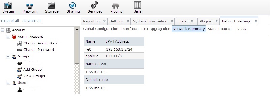

I think i found what the problem could be but dont know how to fix it.

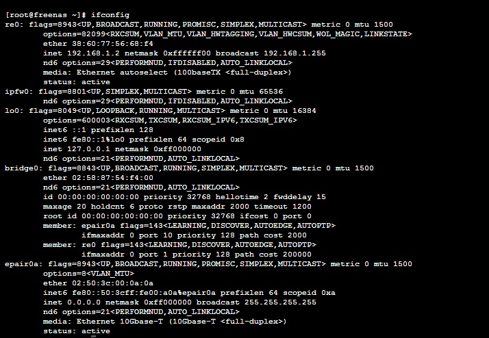

In the Jail/shell i find something strange and this is the issue i need to fix. I am not a network expert but i do hope someone here can help me.
In epair0a there are no IP and the subnet is completely different to my gateway or wireless subnet.
Check the attached file. This happens when i connect it via wireless. Even in the network stats an interface with 0.0.0.0/8 is created instead of the jail ip and required subnet.

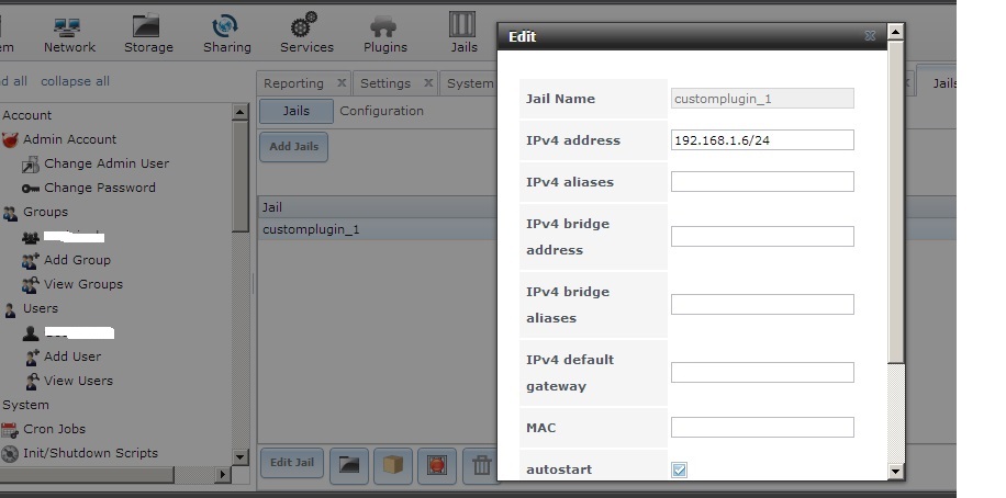

I have the jail configuration and jail ip set up attached in the first post. Is there something amiss that i need to check and clear. I will connect from home and get required logs for someone to diagnose and help.

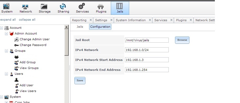

you should remove your jail and start over....
i dont know what that epair is for, you shouldnt have it (at least i dont with the miniDLNA plugin running), but you also shouldnt be allowing your jail to dish out IP addresses from your entire subnet. you are likely to have an IP address conflict at some point.
you need to get your network configs under control first, then worry about setting up your dlna

epair0a is created when the jail runs. Its where one can find the jail ip.
One thing i will check is if the jail is trying to get an IP from the DHCP and the DHCP is not providing the same(or in other words) the modem/router is not providing an IP.
Should i remove the default gateway i set up in the Jail configuration and allow the jail to find a IP?

You have a jail misconfiguration. Delete the jail and start again. Your router should not be handling the dhcp handout of the jails if I remember correctly. Your jail configuration should determine the IP addressing. You most definitely should not overlap your LAN dhcp zone. If your router happens to handout an IP address that is the same as a jail IP you will have fun.
