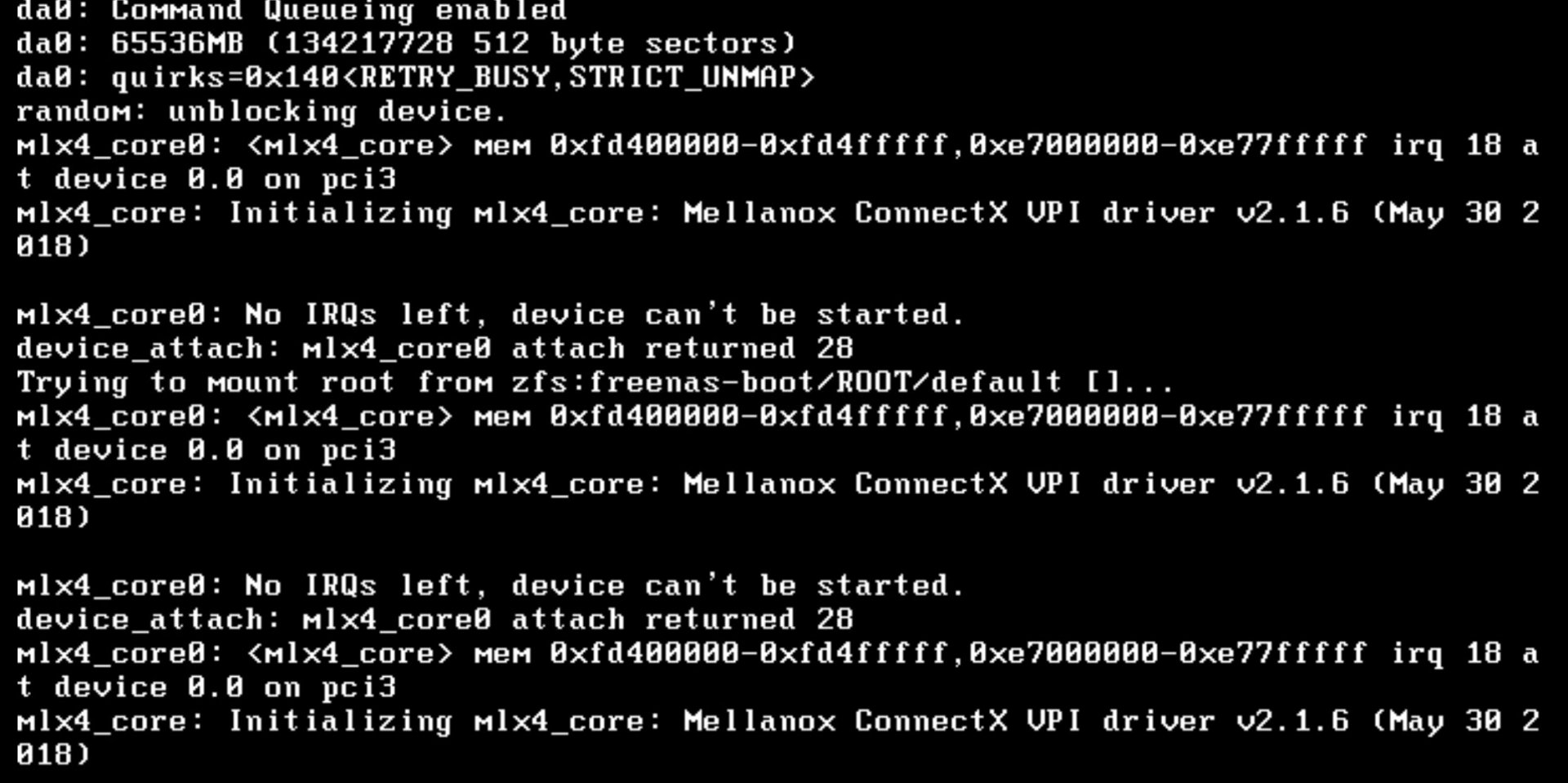

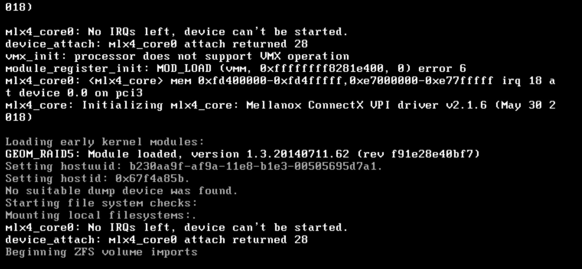

I just tested the
Mellanox ConnectX-3 MCX314A-BCCT
on the esxi with Direct Patch I/O and it can't started
see attachment

Simple answer is not to use esxi
I have 5 of these cards, I run them in Linux routers, freenas, and pfsense(with a little extra work)
Never had a single issue once I got past tuning it correctly

I think pass trough I/O is the same as installing it on bare metal isn't it. If there is no driver !!!
Can you tell me how did you tune adapter that is not showing on freenas I am a newbie in freenas and freebsd
Do you have some guide how to install the driver for this adapter
Thank you
