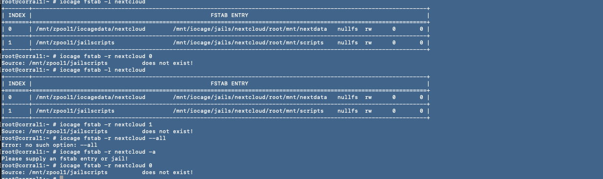

I also had the problem of my purpose built, IOCAGE jails not starting. Clearly the error is tied to FSTAB mounts, and i am getting an error that one of the mount points does not exist (it clearly does). I tried to delete the mount points in U4, via the CLI, and am getting the error that the mount point does not exist... See the attachment.
I revert back to U3 and everything works perfectly. I don't have time right now, but will test the ability to delete the mount points via the CLI in U3, and then recreate them via the GUI in U4. This is clearly a bug, which I would file, but my credentials at the new site are not working, and the reset password email never comes...
