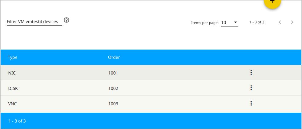

This example shows how a linux VM can loose network connectivity when upgrading from 11.2-BETA2 to 11.2-BETA3 and how it can be restored.
In 11.2-BETA3 all devices attached to VMs are given a "device order number" by the system, whether the VM is pre-existing or newly created. Images vm1 and vm2 below show the system allocated "order numbers" for a pre-existing simple debian VM. The bhyve command invoked when this VM is started can be seen by using the command tail -f /var/log/middleward.log .
2018/09/14 07:00:04] (DEBUG) VMService.run():259 - Starting bhyve: bhyve -A -H -w -c 2 -m 1024 -s 0:0,hostbridge -s 31,lpc -l com1,/dev/nmdm16A -l bootrom,/usr/local/share/uefi-firmware/BHYVE_UEFI.fd -s 4,virtio-net,tap0,mac=00:a0:98:71:dd:6f -s 29,fbuf,vncserver,tcp=192.168.0.151:5743,w=1024,h=768,,wait -s 30,xhci,tablet -s 3:0,ahci,hd:/dev/zvol/NasPool/VM/vmtest4 16_vmtest4

Splitting the bhyve command over separate lines for clarity gives:
bhyve -A -H -w -c 2 -m 1024 /
-s 0:0,hostbridge -s 31,lpc /
-l com1,/dev/nmdm16A /
-l bootrom,/usr/local/share/uefi-firmware/BHYVE_UEFI.fd /
-s 4,virtio-net,tap0,mac=00:a0:98:71:dd:6f /
-s 29,fbuf,vncserver,tcp=192.168.0.151:5743,w=1024,h=768,,wait  /
-s 30,xhci,tablet \
Note in this case the NIC device has been allocated to bhyve pci slot 4.

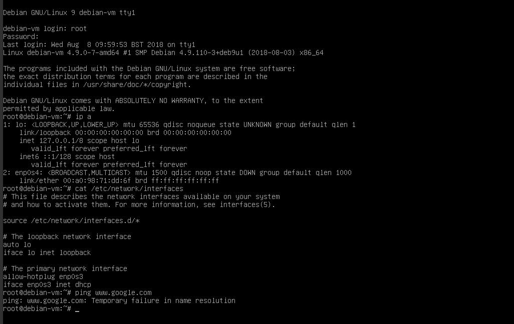

Using VNC to access the debian VM shows its network interface is given the "predictable interface name" of enp0s4. But there is no network connectivity. Looking at the network config file shows this VM was using enp0s3 as its interface name. This is shown in image vm3 below.
To restore the VM's network connectivity you could: (A) reconfigure the VM's network, or (B) change the device order number via the new webUI.

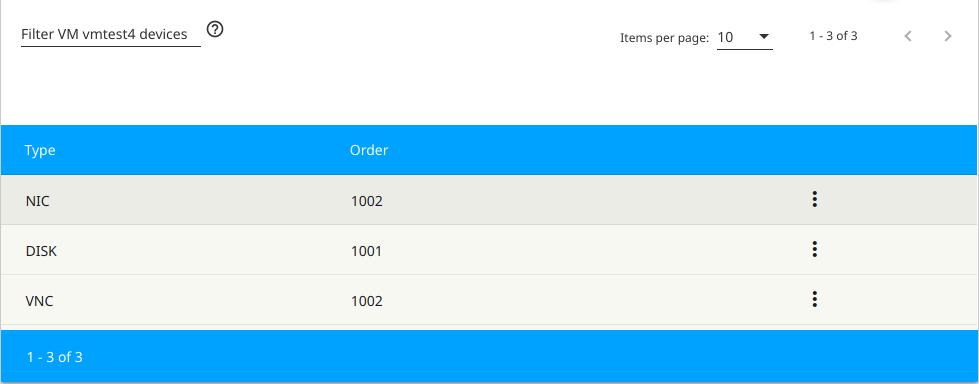

The snag with option (B) is that this feature is so far undocumented and there is not necessarily a simple mapping between the device order number as seen in the webUI and the slots used when bhyve is invoked. However, in this case as we need the NIC attached to slot 3 and not slot 4, we can set the "order number" of the NIC device to that used by the disk device. Just changing the NIC "order number" to 1001 automatically changes those of other attached devices. See image vm4 below.
When the same debian VM is started after this simple change, the bhyve command becomes this:
bhyve -A -H -w -c 2 -m 1024 -s 0:0,hostbridge -s 31,lpc -l com1,/dev/nmdm16A -l bootrom,/usr/local/share/uefi-firmware/BHYVE_UEFI.fd -s 3,virtio-net,tap0,mac=00:a0:98:71:dd:6f -s 29,fbuf,vncserver,tcp=192.168.0.151:5743,w=1024,h=768,,wait -s 30,xhci,tablet -s 4:0,ahci,hd:/dev/zvol/NasPool/VM/vmtest4 16_vmtest4

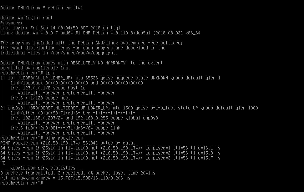

Note the NIC device is now attached to slot 3! Image vm5 shows network connectivity is restored.
