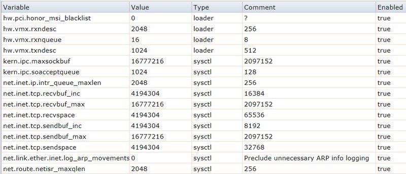

For what it's worth, here are the tunables I use on my systems. I get near-line-rate (~9.8Gb/s)iperfperformance sending & receiving:
EDIT: I documented the system default values in the "Comment" field.
