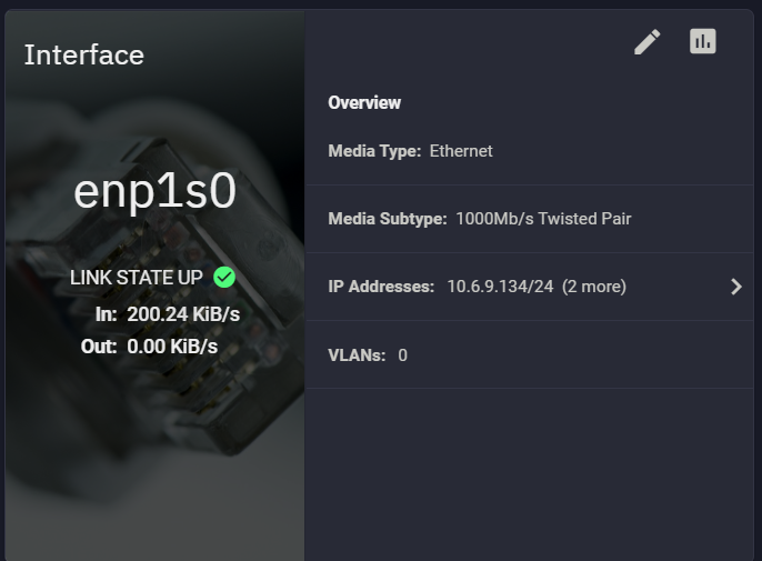

The same thing has happened to me. I built a new NAS with a 10G card, which worked fine for weeks. Then the other day my read and write speeds went way down. After looking into it, I noticed that it was saying 1000 instead of 10000. I have another NAS running Core with a 10G card and it is just fine. Everything on my 10G network is running as it should for 10G except this new build. I have no clue how to fix it. The last thing I did before it happened was I turned on ISCSI service.
