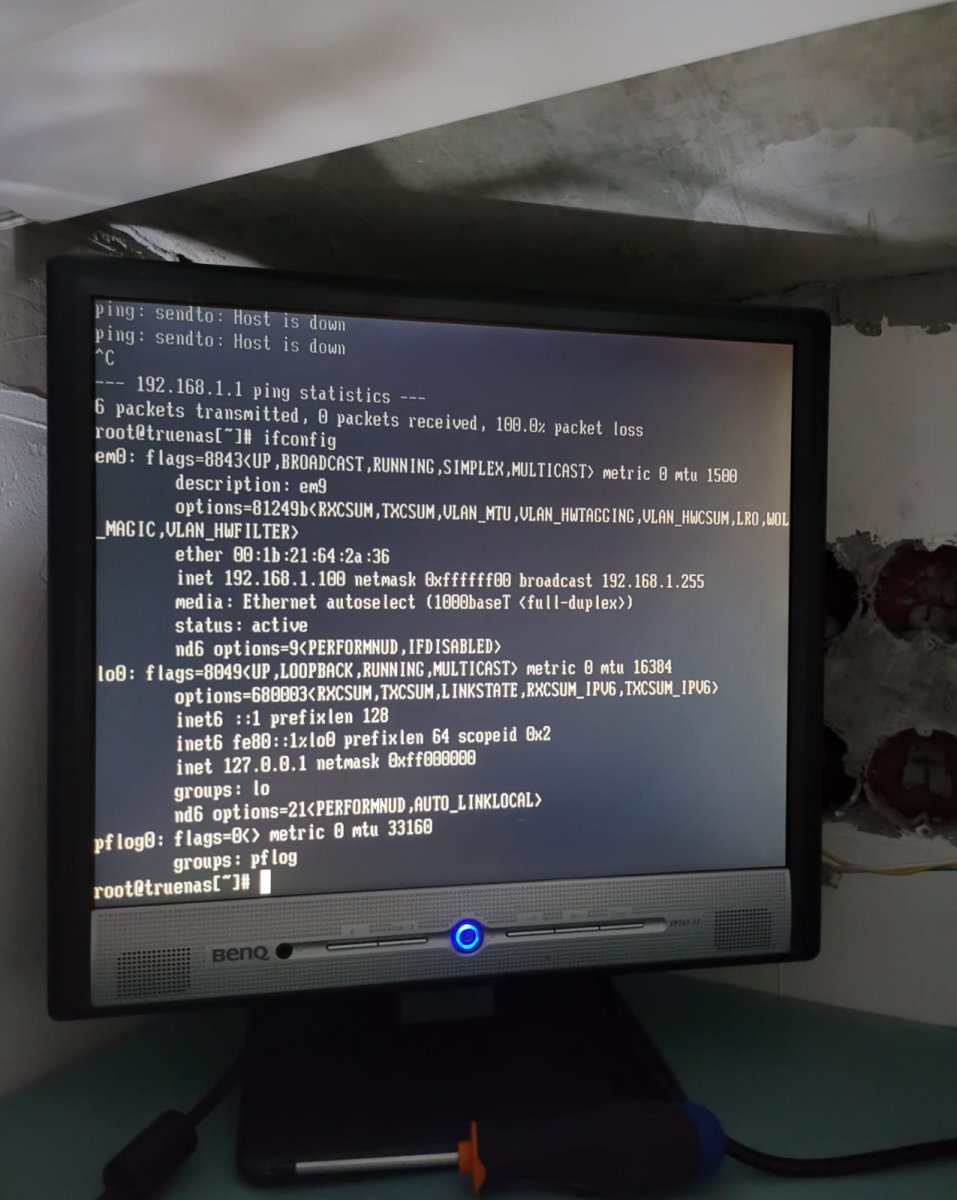

Unlucky after installing Intel network card.
Same shit. Any ideas?

BET4
Jul 1, 2012
20
SOLVED. Smelly cat asus rtn56u lan died. Direclty plug to ISP cable et voila it got IP from ISP. An old guy WL500W was unboxed and started work. RTN56U going to hell
