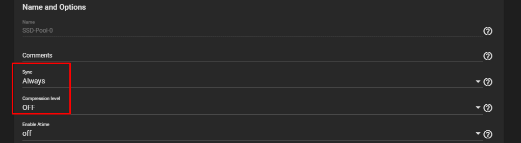

Before measuring, I turned off the cache:
zfs set primarycache=none SSD-Pool-0
Mode - synchronous
Compression - off
Here you can see that the cache is empty:

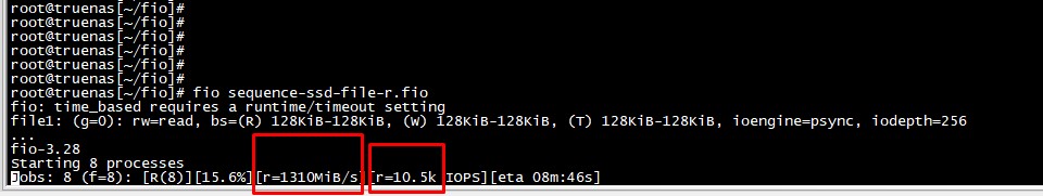

Ran a sequential read test locally on the server:
1670350983854-jpeg.60644

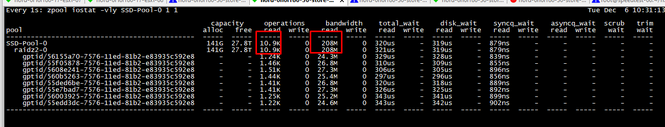

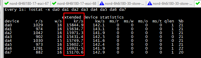

Ran zpool iostat -vly .
I read the numbers and they don't beat. Please explain or provide material to explain:
Why is bandwidth so low with IOPs equal to IOPs fio.
How are these numbers calculated?
10,5k(iops)*128k(bs)=1 344Mib
zpool iostat shows 209Mib
1670351512067-png.60647

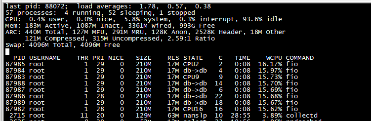

Processor not loaded:

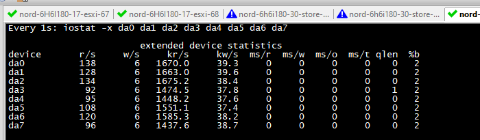

Server after reboot, cache 100% empty.
After starting FIO, FIO shows a read speed of 1300Mb/s.
iostat shows hard drive load ~ 17Mb/s
Can you please explain how these numbers are correlated? Is he reading from the air?
